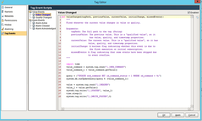

Hello,
I have a problem in the changed value of a tag. I put this script:
[i]import time
value\_command = system.tag.read("[.]NEW\_COMMAND")
value\_command\_1 = value\_command.getValue()
query = (“UPDATE scd\_command SET id\_command\_status = 1 WHERE cd\_command = %i”)
system.db.runUpdateQuery(query % (value\_command\_1))
value = system.tag.read("[.]HEADER")
value\_1 = value.getValue()
system.tag.write("[.]FOOTER", value\_1)
time.sleep(1)
system.tag.write("[.]WRITE\_FOOTER",0)[/i]
But it gives me this error:
Valuechanged type error ‘str’ object is not callable
I tried the script playground and I do not return this error.
Can you help to solve?
Thanks
 ![](https://us1.discourse-cdn.com/inductiveautomation/original/2X/4/49dc63de65005eb8f4ac58a7126d83d8dcb391a2.png)
**Author:** ![JGJohnson](https://sea1.discourse-cdn.com/inductiveautomation/user_avatar/forum.inductiveautomation.com/jgjohnson/32/29582_2.png) [@JGJohnson](https://forum.inductiveautomation.com/u/JGJohnson)\
**Post date:** [July 23, 2015, 5:45pm UTC](https://forum.inductiveautomation.com/t/valuechanged-type-error-str-object-is-not-callable/10262/2 "2015-07-23T17:45:11Z")
Try this instead:
query = "UPDATE scd_command SET id_command_status = 1 WHERE cd_command = %i" % value_command_1
system.db.runUpdateQuery(query)`
