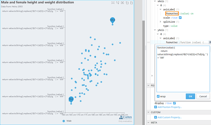

**Author:** ![Michal\_Goralczyk](https://sea1.discourse-cdn.com/inductiveautomation/user_avatar/forum.inductiveautomation.com/michal_goralczyk/32/55564_2.png) [@Michal\_Goralczyk](https://forum.inductiveautomation.com/u/Michal_Goralczyk)\
**Post date:** [July 14, 2025, 10:01am UTC](https://forum.inductiveautomation.com/t/vcortex-i4cortex-visualization-component-pack/100186/25 "2025-07-14T10:01:18Z")
Hello, interesting module. I have a question is it possible to use formatter for chart axes?

**Author:** ![nader.chinichian](https://sea1.discourse-cdn.com/inductiveautomation/user_avatar/forum.inductiveautomation.com/nader.chinichian/32/9261_2.png) [@nader.chinichian](https://forum.inductiveautomation.com/u/nader.chinichian)\
**Post date:** [July 14, 2025, 11:14am UTC](https://forum.inductiveautomation.com/t/vcortex-i4cortex-visualization-component-pack/100186/26 "2025-07-14T11:14:45Z")
Of course anything is possible if you are good at JS. Use following code in yAxis object:
```python
yAxis: {
    type: 'value',
    axisLabel: {
      formatter: function (value) {
      return value.toString().replace(/\B(?=(\d{3})+(?!\d))/g, ' ') + ' kW';
To best way to test this javascript code is goto echarts example page and edit code online and check the result if it is Ok, just copy and paste it into Perspective.
**Post date:** [July 14, 2025, 11:42am UTC](https://forum.inductiveautomation.com/t/vcortex-i4cortex-visualization-component-pack/100186/27 "2025-07-14T11:42:38Z")
I understand. I tried doing it, and the formatter is treated as a string. Can you explain what I'm doing wrong? I thought it wasn't working, hence my question.
**Post date:** [July 14, 2025, 1:11pm UTC](https://forum.inductiveautomation.com/t/vcortex-i4cortex-visualization-component-pack/100186/28 "2025-07-14T13:11:25Z")
[Test.zip](https://forum.inductiveautomation.com/uploads/short-url/3XYLTqvIxNXuuPiPG4D9A7gp2nP.zip) (31.3 KB)
Oh, it seems you use the old version.
Please download the new version from the site.
The new update which support JavaScript, doesn't have trail logo on the components anymore.
[Direct download](https://i4cortex.com/download/4296/?tmstv=1733860350&ebduid=6cda3bd385)
**Post date:** [July 15, 2025, 7:39am UTC](https://forum.inductiveautomation.com/t/vcortex-i4cortex-visualization-component-pack/100186/29 "2025-07-15T07:39:24Z")
Wow looks really good, this is what I was looking for!

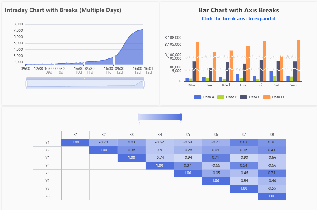

**Post date:** [October 10, 2025, 2:55pm UTC](https://forum.inductiveautomation.com/t/vcortex-i4cortex-visualization-component-pack/100186/38 "2025-10-10T14:55:42Z")
We’re excited to announce **vCortex 0.1.55 (Ignition 8.1)**, packed with major improvements, new customization options, and better performance for your projects!
### **New Features & Enhancements**
- Updated the internal eCharts library to the latest v6 release. Includes new chart types, improved rendering, and overall better compatibility.
- Added fresh demo charts showcasing v6 capabilities in the vCortex demo project.
- Reduce module runtime size reduced by **~50%**. This reduce project resources and having faster project startup.
- Add runJS() function to the eCharts component to run custom JavaScript code for directly invoking the eCharts API. This allows updating large chart datasets directly in the chart without passing them through props, to improving performance. This is specially important in designer to prevent designer from crashing. We tested up to 1M points! Please refer to [Documentation - Apache ECharts](https://echarts.apache.org/en/api.html#echartsInstance) for all available API.
- Add renderer option to eCharts for canvas and SVG. Canvas: Faster performance and better for large data sets. SVG: Sharper graphics and easier to export or style with CSS and lower memory for mobile devices, but may be slower with complex charts.
- Add noMerge option to eCharts. When enabled, the chart will be fully re-rendered each time setOption is changed, instead of merging new options with the existing configuration. Use this when your data structure changes significantly or you want to reset the chart state on update.
- Add useDirtyRect option to eCharts. When enable with the Canvas renderer, the dirty rectangle rendering technique detects and updates only the parts of the view that have changed, rather than any changes causing a complete redraw of the canvas.
- Add lazyUpdate option to eCharts. Defers chart updates to the next animation frame instead of updating immediately. Helps with smoother performance on complex dashboards.
- Add initValue to the Odometer to set the starting number shown when the component first loads. This value is used only on initialization; later updates use the props.value.
### **Bug Fixes**
- Move theme object from props.setOption to props to prevent unwanted chart refreshes.
- Fix theme switching issue in eCharts 3D.
- Remove CSS variables which conflict with IA variables.

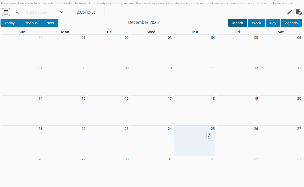

**Post date:** [October 24, 2025, 9:41am UTC](https://forum.inductiveautomation.com/t/vcortex-i4cortex-visualization-component-pack/100186/39 "2025-10-24T09:41:08Z")
### vCortex Now Supports Ignition 8.3!
We’re excited to announce that **vCortex** is now fully compatible with **Ignition 8.3**!
Along with this update, we’re also change our **versioning system:**
As we introduce **Ignition 8.3 support** , we are change our versioning system to make it clearer and more consistent across releases. This update will help users easily identify which Ignition version a release targets and how many components are included in the module.
`MAJOR.MINOR.PATCH`
1. **MAJOR** → Indicates the Ignition compatibility
  - `0` → Ignition 8.1.x
  - `1` → Ignition 8.3.x
2. **MINOR** → Represents the number of included components in the module
3. **PATCH** → Identifies incremental updates, fixes, or optimizations
Changelog (v0.13.56, v1.13.56):
- Fixed return index value issue in events of the Calendar component.
- Added pagination to the Calendar component to improve UI performance when handling a large number of events.
- Added an `enabled` property to Calendar events. Users can now disable specific events and define the disabled style via `style.eventDisabled`.
- Added hover mode for Calendar events, displaying the event’s `startDate` and `endDate` on mouse hover.
- Added `recurring`, `rrule`, and `text` properties to the Calendar event schema. Developers can use the `recurring` and `rrule` properties to implement custom recurrence logic. The rrule property can be processed via Ignition Python scripts to generate recurring events.
- Fixed a bug in the Calendar where moving one of several events with the same ID caused all related events to move together.
- Improved components resource loading. JavaScript and CSS files are now modularized per component to reduce project startup load. Only the resources for components actually used in the project are now loaded, minimizing initial runtime load time.
- Added a Scheduler page to the demo project to demonstrate how to implement recurring logic in the Calendar.
![calnder](https://us1.discourse-cdn.com/inductiveautomation/original/3X/2/7/276dab568260ecb96d020b8de867913c6875a36a.gif)
Note: Those who already installed the older version of module in 8.3 please uninstall the module, reset the gateway and install the new version and restart again, otherwise the changes doesn’t apply.
