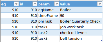

How could I change my database design to improve a query like the one above?
Here is how my current data is being stored.
 ![SELECT_UNION_sameTable2](https://us1.discourse-cdn.com/inductiveautomation/original/2X/c/cd09f7137344b8cde92188c99b19d09ed372daec.png)

**Post date:** [January 29, 2020, 4:13pm UTC](https://forum.inductiveautomation.com/t/ver-7-9-4-reports-table-display-columns-from-same-db-table-entry-as-separate-rows/31701/7 "2020-01-29T16:13:01Z")
> [@paulm1](#):
You would be looking at storing it in a block.
 ![2020-01-29_10-57-02](https://us1.discourse-cdn.com/inductiveautomation/original/2X/7/72886efadc106b2b6b4f0c6a881eee079d9450ee.png)
Your query would then be something like:
```sql
SELECT value FROM prevent
WHERE eq = ? and id = ? and param in ('task1', 'task2', 'task3')
On the other hand, you could improve performance on what you have by using UNION ALL instead of UNION. UNION ALL does not use an index in its temporary tables and also doesn't use DISTINCT.
UNION by itself is short for UNION DISTINCT, which skips duplicate rows, and is a bit more expensive to use.
