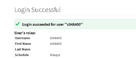

I created a AD authentication profile and when I try to test it with “verify user source”, it gateway portal hangs. I also don’t see any logs wrapper.log file. the last message in the log file is given below.
Could not read license from HASP key. HASP login() failed. Last error = 14.
Attached here is the screenshot of the gateway configuration.

**Post date:** [February 19, 2019, 5:57pm UTC](https://forum.inductiveautomation.com/t/verify-user-source-against-active-directory-hangs/22681/2 "2019-02-19T17:57:48Z")
Can you open another tab and go to the threads page to get a thread dump while this page is hanging?

**Post date:** [February 19, 2019, 6:37pm UTC](https://forum.inductiveautomation.com/t/verify-user-source-against-active-directory-hangs/22681/3 "2019-02-19T18:37:31Z")
Well, I got success after a long wait. Is there any settings that I need to turn on to make it respond fast?

If you test a second time right after, is it faster?
How many users are in your AD? Do you have ignition set to import all users?

**Post date:** [February 19, 2019, 6:59pm UTC](https://forum.inductiveautomation.com/t/verify-user-source-against-active-directory-hangs/22681/6 "2019-02-19T18:59:06Z")
It would be about 2000 users. No I do set Ignition to import all users.

**Post date:** [February 19, 2019, 7:12pm UTC](https://forum.inductiveautomation.com/t/verify-user-source-against-active-directory-hangs/22681/7 "2019-02-19T19:12:26Z")
The second time was faster than the first one. But subsequent tries are getting worse…

**Post date:** [February 20, 2019, 6:28pm UTC](https://forum.inductiveautomation.com/t/verify-user-source-against-active-directory-hangs/22681/8 "2019-02-20T18:28:16Z")
It is working for AD hybrid sources.
