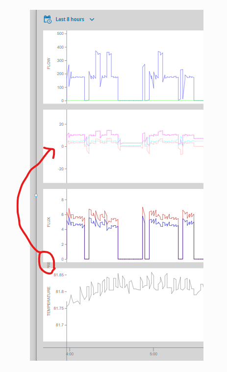

Hello! Is it possible to vertically center an axis label on a powerchart? Attached is an image for reference.
 ![Capture](https://us1.discourse-cdn.com/inductiveautomation/original/3X/a/6/a6c53efc0aedc9c77db2403143466e544da9c979.png)

**Post date:** [June 22, 2023, 7:02am UTC](https://forum.inductiveautomation.com/t/vertically-center-axis-label-on-powerchart/75339/3 "2023-06-22T07:02:40Z")
![image](https://us1.discourse-cdn.com/inductiveautomation/original/3X/b/c/bc73e7c65b79ca035ef14a0a7e83eebf6d70ff41.png)
can be done in the designer
translate: 0px 45%
text-anchor: middle
(percentage might differ to be 50% depending on other enabled features i guess)

ahh hmm if you dont want to botehr with that its targetable with the css selector .yaxislabel too i guess
```auto
.psc-yourClass .yaxislabel {translate: 0px 45%; text-anchor: middle;}

**Post date:** [June 22, 2023, 5:09pm UTC](https://forum.inductiveautomation.com/t/vertically-center-axis-label-on-powerchart/75339/7 "2023-06-22T17:09:40Z")
Your translate is set to 95%, it should be **45%**.
The text-anchor changes where labels anchor point is. Moving it to middle without changing it's position will move it up.

**Post date:** [June 22, 2023, 7:50pm UTC](https://forum.inductiveautomation.com/t/vertically-center-axis-label-on-powerchart/75339/9 "2023-06-22T19:50:54Z")
Did you test it in the browser? In my testing, when I put in the values exactly as @victordcq stated it did not work in the designer but when I ran a client in a browser it worked as expected.

**Author:** ![tgarrison](https://sea1.discourse-cdn.com/inductiveautomation/user_avatar/forum.inductiveautomation.com/tgarrison/32/80965_2.png) [@tgarrison](https://forum.inductiveautomation.com/u/tgarrison)\
**Post date:** [August 8, 2025, 3:04pm UTC](https://forum.inductiveautomation.com/t/vertically-center-axis-label-on-powerchart/75339/16 "2025-08-08T15:04:08Z")
> [@victordcq](#):
> `.psc-yourClass .yaxislabel {translate: 0px 45%; text-anchor: middle;}`
Anyone happen to have a tweak to make this work on charts with multiple plots? The 45% appears to be using the size of the overall chart..
**Post date:** [August 11, 2025, 5:01pm UTC](https://forum.inductiveautomation.com/t/vertically-center-axis-label-on-powerchart/75339/18 "2025-08-11T17:01:14Z")
The 3 that are in the proper position I set to 10%. The one that’s circled is set to 45%. I’m thinking I need to come up with a way to know how many plots are visible, how much area each plot is taking up (using it’s weight?) and then come up with some math that figures the correct % for each. Won’t be able to do it via stylesheet, but should be able to do it via style props..
