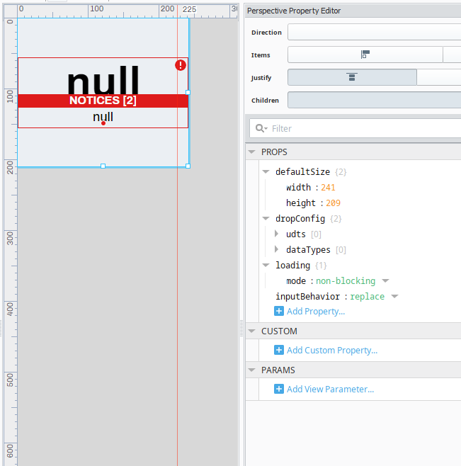

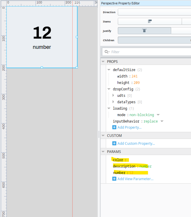

Hello,
For some time now, I have been experiencing an issue in the designer. When I work on views, run them, and confirm, sometimes the parameter configuration disappears. This happens occasionally. Has anyone encountered this problem?
 ![image](https://us1.discourse-cdn.com/inductiveautomation/original/3X/e/b/eb2a019a0e7da3b66164f6fee38274fc19218a92.png)
I need to add the params again...
 ![image](https://us1.discourse-cdn.com/inductiveautomation/original/3X/9/c/9c77180ef28fee63de414344eed09a45c2a5ea95.png)

**Author:** ![bmpaz](https://sea1.discourse-cdn.com/inductiveautomation/user_avatar/forum.inductiveautomation.com/bmpaz/32/76418_2.png) [@bmpaz](https://forum.inductiveautomation.com/u/bmpaz)\
**Post date:** [June 12, 2025, 1:56pm UTC](https://forum.inductiveautomation.com/t/view-parameter-configuration-is-lost/107321/2 "2025-06-12T13:56:12Z")
I've experienced a very similar issue with session variables. They would disappear. I would add them back in, save project and close the Designer, but they would disappear again. I remedied this by doing an export of the project from the gateway, deleting the project and then re-importing. Then I created the variables again and saved the project and they stayed. It appeared to be some sort of corruption within the project somewhere.
**Post date:** [June 12, 2025, 3:12pm UTC](https://forum.inductiveautomation.com/t/view-parameter-configuration-is-lost/107321/3 "2025-06-12T15:12:41Z")
IA is having difficulty finding people with this problem who can help reproduce it while IA watches. Please open support tickets. Let IA investigate in your environment. Heisenbugs need lots of exposure to capture.
