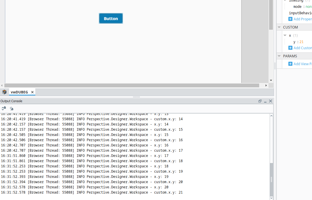

Hi guys, if anyone can explain to me what’s going on, I’d appreciate.
I made a view on which I added an object property `x`, which has an integer member named `y`.
Then I added a button with the following onClick script:
```auto
custom = self.view.custom
x = custom.x
x.y = x.y + 1
system.perspective.print('x.y: %s' % x.y)
system.perspective.print('custom.x.y: %s' % custom.x.y)
And clicking on the button gives me this…
 ![Setup.1](https://us1.discourse-cdn.com/inductiveautomation/original/3X/a/5/a5a3330a7455e7ffac430e3b14029ac8aaef25b1.png)
In other words, after incrementing `x.y`:
- `x.y` returns the previous value.
- `custom.x.y` returns the current value.
I don’t get it :s

**Author:** ![gdube](https://sea1.discourse-cdn.com/inductiveautomation/user_avatar/forum.inductiveautomation.com/gdube/32/41701_2.png) [@gdube](https://forum.inductiveautomation.com/u/gdube)\
**Post date:** [March 30, 2022, 8:18pm UTC](https://forum.inductiveautomation.com/t/view-properties-issue/57832/3 "2022-03-30T20:18:39Z")
What’s troubling me is that assigning `y` via the `x` copy will increment `self.view.custom.x.y`, but not the `x` copy. As if there’s a redirection on the copy, or the copy is read-only ?
**Post date:** [March 30, 2022, 8:34pm UTC](https://forum.inductiveautomation.com/t/view-properties-issue/57832/5 "2022-03-30T20:34:35Z")
Well it’s somehow incrementing the real thing, see the output when I click on the button repeatedly.
 ![image](https://us1.discourse-cdn.com/inductiveautomation/original/3X/7/2/72e5bac3c8cf771ea35da6af39de8cf8b0be5545.png)
I agree I’ll avoid it now that I know the pitfalls. It’s still a strange behavior to me, and I can’t explain to myself how the copy affects the real property but not itself.
**Post date:** [March 30, 2022, 9:09pm UTC](https://forum.inductiveautomation.com/t/view-properties-issue/57832/6 "2022-03-30T21:09:50Z")
It’s basically just a bug.
