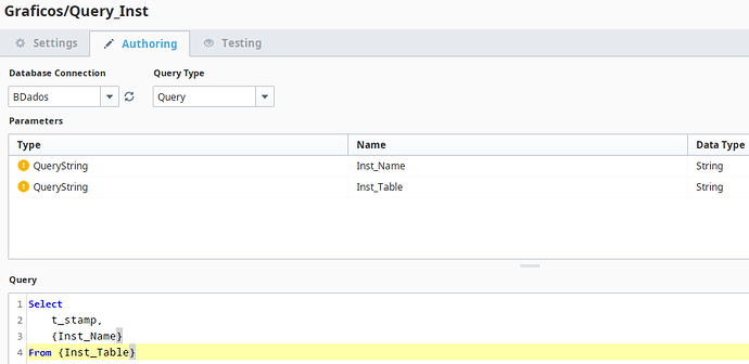

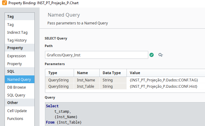

Hi, I’m new to this forum. I’m trying to bind my parameters `{Inst_Name}` and `{Inst_Table}` using a named query chart to pass my udt tag values; Although it is working during runtime, when I open my template, I got a cyclic error popup in my parameter. My Named Query “Query\_Inst“ is very simple:
`Select`
`t_stamp,`
`{Inst_Name}`
`From {Inst_Table}`
Inst\_Name and Inst\_Table are my column and table names of type QueryString in SQL Server; When I bind my UDT Tags in the value field in the chart - {INST\_PT\_Projeção\_P.Dados::CONF.TAG} for Inst\_Name and - {INST\_PT\_Projeção\_P.Dados::CONF.Hist} for Inst\_Table I get this error:
`java.lang.Exception: Error running query:com.inductiveautomation.factorypmi.application.gateway.NQuery@16b700a4@6000msOn: INST_PT_Projeção_P.INST_PT_Projeção_P.Chart.Dataat com.inductiveautomation.factorypmi.application.gateway.QueryManager$QueryExecutor.run(QueryManager.java:311)at java.base/java.lang.Thread.run(Unknown Source)Caused by: com.inductiveautomation.ignition.client.gateway_interface.GatewayException: java.lang.Exception: Missing value for query parameter {Inst_Name}`
any help would be greatly appreciated!

The error only occurs in edition mode when I open my template. In runtime my chart works ok. I took these prints to ilustrate how I built my template and the SQL query:

Can you also show your template's parameter setup/config? Cyclic error is something that should not be happening, full stop.
Also, on the query binding dialog, select the value box for each parameter and press enter. I've seen where just clicking outside of the box does not apply the expression.
Completely different (but related) topic, based on your query, each device has a separate DB table in the database, correct? Is there a reason why you don't have a single tall table with a column for `value`, `deviceId` and `timestamp`? That would allow you to filter on just the device ID, and maybe timespan, instead of using query strings in a named query. It also allows you to add/remove devices without having to deal with adding or removing tables.

I would advise _against_ using UDT parameters, and instead pass the tag path to the UDT instance you want to target/use as a string to your template. From there, bind template custom properties indirectly to necessary UDT members, using the tag path passed to build the full path.
You can find plenty of posts on the forums on why using UDT parameters on views/templates is not recommended.

B → Once I configure my NamedQuery parameter value inside my template chart as `{INST_PT_Projeção_P.Dados::CONF.TAG}` for `{Inst_Name}` and - `{INST_PT_Projeção_P.Dados::CONF.Hist`} for `{Inst_Table}`, the error popup keeps reappearing at a set rate.
`{INST_PT_Projeção_P.Dados::CONF.TAG}` and `{INST_PT_Projeção_P.Dados::CONF.Hist}` are the paths built by the “Insert Property“ button, ![Insert_Property](https://us1.discourse-cdn.com/inductiveautomation/original/3X/5/6/560d035d7d013c94e539b2abb2891c171e4f5641.png) pointing to my template custom parameter “Dados“ in wich we found `.CONF.TAG` and `.CONF.Hist` members, from my UDT.
