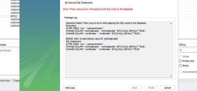

Does anyone know the correct MySQL data format to allow me to use the Named Query result as a controller for the Vision checkbox? I tried BIT(1), TINYINT but no luck?

I don't, but I can see that the Default/Expression is '1' which is a string.
SQL syntax, surely, would be `TRUE` or `1`?
Do I see more apostrophes on the next columns default as well?

I had tried 1, TRUE:

I use TINYINT(1) which i believe is what BIT(1) is an alias for.
**Post date:** [July 15, 2025, 8:39pm UTC](https://forum.inductiveautomation.com/t/vision-checkbox-mysql/108523/5 "2025-07-15T20:39:21Z")
`DEFAULT 'TRUE'` is also a string.
Try `DEFAULT TRUE`.
`'TRUE'` is a string. `TRUE` is a boolean.

I got it to work by doing the TINYINT and setting default to = 1
I noticed once I write this change to the database, it will go back and reset that 1 to equal '1'. Seems like it doesn't mind in this case.

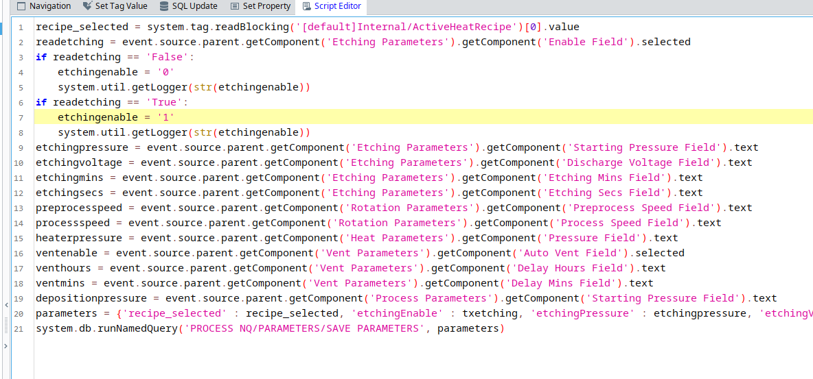

I got the checkbox to be happy querying this type. But, when reading back the checkbox value, it will convert 1 = 'TRUE', 0 = 'FALSE', which is a problem when reading the checkbox value and updating the database.
I figured this script would do it:
 ![image](https://us1.discourse-cdn.com/inductiveautomation/original/3X/2/f/2f1a222d29b6db12a6f92d15aa670f129e533a04.png)
But, it considers 'etchingenable' as undefined if I put that into the parameters string. What would be the correct way to format that change?

Please see [Wiki - how to post code on this forum](https://forum.inductiveautomation.com/t/wiki-how-to-post-code-on-this-forum/77831) so that someone can copy it and edit.
Is `etchingenable` a string? You're assigning a string variable to it.

Here's the script:
```python
recipe_selected = system.tag.readBlocking('[default]Internal/ActiveHeatRecipe')[0].value
readetching = event.source.parent.getComponent('Etching Parameters').getComponent('Enable Field').selected
if readetching == 'False':
	etchingenable = '0'
if readetching == 'True':
	etchingenable = '1'
etchingpressure = event.source.parent.getComponent('Etching Parameters').getComponent('Starting Pressure Field').text
etchingvoltage = event.source.parent.getComponent('Etching Parameters').getComponent('Discharge Voltage Field').text
etchingmins = event.source.parent.getComponent('Etching Parameters').getComponent('Etching Mins Field').text
etchingsecs = event.source.parent.getComponent('Etching Parameters').getComponent('Etching Secs Field').text
preprocesspeed = event.source.parent.getComponent('Rotation Parameters').getComponent('Preprocess Speed Field').text
processspeed = event.source.parent.getComponent('Rotation Parameters').getComponent('Process Speed Field').text
heaterpressure = event.source.parent.getComponent('Heat Parameters').getComponent('Pressure Field').text
ventenable = event.source.parent.getComponent('Vent Parameters').getComponent('Auto Vent Field').selected
venthours = event.source.parent.getComponent('Vent Parameters').getComponent('Delay Hours Field').text
ventmins = event.source.parent.getComponent('Vent Parameters').getComponent('Delay Mins Field').text
depositionpressure = event.source.parent.getComponent('Process Parameters').getComponent('Starting Pressure Field').text
parameters = {'recipe_selected' : recipe_selected, 'etchingEnable' : txetching, 'etchingPressure' : etchingpressure, 'etchingVoltage' : etchingvoltage, 'etchingMins' : etchingmins, 'etchingSecs' : etchingsecs, 'processSpeed' : processspeed, 'heaterPressure' : heaterpressure, 'ventEnable' : ventenable, 'ventHours' : venthours, 'depositionPressure' : depositionpressure}
system.db.runNamedQuery('PROCESS NQ/PARAMETERS/SAVE PARAMETERS', parameters)
**Author:** ![josborn](https://avatars.discourse-cdn.com/v4/letter/j/4bbf92/32.png) [@josborn](https://forum.inductiveautomation.com/u/josborn)\
**Post date:** [July 15, 2025, 9:12pm UTC](https://forum.inductiveautomation.com/t/vision-checkbox-mysql/108523/9 "2025-07-15T21:12:05Z")
There shouldn't be any issues with writing a Boolean back to the database. You cannot write a string back, why type is your parameter that is writing back to the database?
Also i dont see where you have defined "txetching" `'etchingEnable' : txetching`

txetching should read etchingenable, almost certainly

Sorry, I deleted txetching = etchingenable line because it was throwing an error. Issue is etchingenabled goes undefined with these if statements
**Post date:** [July 16, 2025, 3:01pm UTC](https://forum.inductiveautomation.com/t/vision-checkbox-mysql/108523/12 "2025-07-16T15:01:39Z")
You didn't address my earlier comments about is `etchingenable` a string?
```python
if readetching == 'False': # <--- You're checking for a string, not a bool.
	etchingenable = '0' # <--- You're writing a string.
if readetching == 'True': # <--- You're checking for a string, not a bool.
	etchingenable = '1' # <--- You're writing a string.
> [@warren](#):
> Issue is etchingenable **d** goes undefined with these if statements
Take care with your writing. The variable name is `etchingenable`.
**Author:** ![warren](https://avatars.discourse-cdn.com/v4/letter/w/97f17d/32.png) [@warren](https://forum.inductiveautomation.com/u/warren)\
**Post date:** [July 16, 2025, 3:27pm UTC](https://forum.inductiveautomation.com/t/vision-checkbox-mysql/108523/13 "2025-07-16T15:27:46Z")
Yes etchingenable was a string in the NQ, which was throwing the whole thing off. I am able to ignore this whole set of if statements and just use readBlocking on the checkbox. Everything is happy with that. Thanks you!
