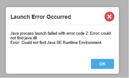

Hi, guys,
After upgrade from 8.0.4 to 8.1.13, the following error pops up after trying to start Vision Client Launcher:
![image](https://us1.discourse-cdn.com/inductiveautomation/original/3X/4/8/48bbbfe26a14d20e089d6f5e629e2de82da8b0dd.png)
Any idea how to sort out that?
Regards,
D.Vasilev

Sometimes deleting the folder `"C:\Users\USER_NAME\.ignition\cache"` works to clear up errors like this, assuming a windows installation. I don’t know where that folder lives on other operating systems.

It worked, thanks a lot!
