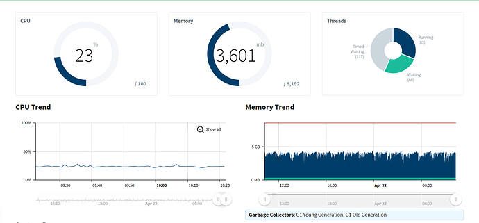

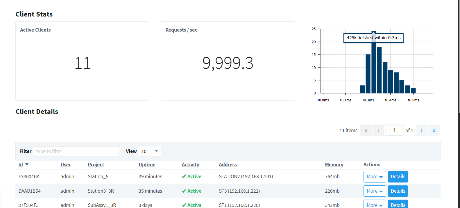

Previously, I worked with only four clients, and the client response time was almost instantaneous for everything.
The client asked me to add more stations; now we have 11 clients, and I've noticed some delay with clients.
The client application is simple; it basically consists of screen changes so station operators can follow instructions (there are a lof of step for operators, so, i have a lot of screens). Among the 11 clients, I also control 15 Atlas tools using Open Protocol, and all 11 clients write data to a database simultaneously.
Things I think are wrong:
- I have a lot of system.tag.readBlocking and system.tag.writeBlocking on all clients. I've read that this isn't ideal.
- I have a client running on the gateway. Ideally, the gateway should be installed on a computer without clients.
- I don't have an SSD in the gateway. I don't know if installing one would improve it. Should I install SSDs on the clients as well?
Any other tips would be greatly appreciated. Thanks.
 ![Screenshot 2025-04-21 090616](https://us1.discourse-cdn.com/inductiveautomation/original/3X/a/a/aa1960622329f240bc6f2ae085cc6e6f8ca561a8.png)
 ![Screenshot 2025-04-21 092159](https://us1.discourse-cdn.com/inductiveautomation/original/3X/2/5/25b15229587aa8bf6cd5a56a69c6845da7f1ef03.png)
 ![image](https://us1.discourse-cdn.com/inductiveautomation/original/3X/1/b/1bde24f1ec9f55a4372d60a8ea95d4130937eef9.png)
 ![image](https://us1.discourse-cdn.com/inductiveautomation/original/3X/8/4/84511d3069e1182cb39b78a46f1f9ec284fa64c2.png)

**Author:** ![Leonel](https://avatars.discourse-cdn.com/v4/letter/l/4491bb/32.png) [@Leonel](https://forum.inductiveautomation.com/u/Leonel)\
**Post date:** [April 29, 2025, 3:58pm UTC](https://forum.inductiveautomation.com/t/vision-client-request-sec-too-high/105413/11 "2025-04-29T15:58:23Z")
Okay, I have been following all of your tips and this is the result:
 ![image](https://us1.discourse-cdn.com/inductiveautomation/original/3X/d/3/d387b48caef7e7bcf97385c8ac954c0225b7a4aa.png)
Now the only problem is that I have some requests that are 100-200ms, which seems too high. I don't know if there's a way to find out which client/script is causing this, but when I close client #1, those long times disappear. I'll start checking all the scripts on client #1 to see if I see anything strange.
Thanks everyone!
**Post date:** [April 29, 2025, 4:00pm UTC](https://forum.inductiveautomation.com/t/vision-client-request-sec-too-high/105413/12 "2025-04-29T16:00:33Z")
Those are reasonable numbers. By default, a Vision client will poll for tag updates every 250ms, so 44 of the 63 requests per second are accounted for.
