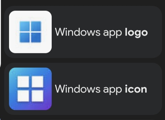

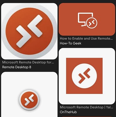

The connection/process is very similar to RDP. I have a Windows CPC and you have to use an app called Windows App now, (image 1). Microsoft used to have an app called Microsoft Remote Desktop that looked like image 2 below, but they sunset that already. That was the previous way I used to connect and it was exactly like the traditional RDP method but you could store/save connections with credentials. It’s a whole mess but you cannot use Windows Apps to RDP into traditional Servers, only CPC's but that limitation only exists when running on a Windows PC. If you have Android, iOS, or MacOS, you can use the Windows App to rdp to CPC's and traditional local/cloud servers. There are some fun reddit posts about this topic and how hilarious it is that MS would make a product that doesn't fully work on a Windows device but does on other platforms.
Image 1:
 ![Screenshot_20250819_071316_Chrome](https://us1.discourse-cdn.com/inductiveautomation/original/3X/f/4/f4d6b36ba10a6bfb37cb0394de1859b175d40c62.jpeg)
Image 2:
 ![Screenshot_20250819_070930_Chrome](https://us1.discourse-cdn.com/inductiveautomation/original/3X/d/f/df0bd858dc5dff8e6c02267f57ca735939342e3f.jpeg)
