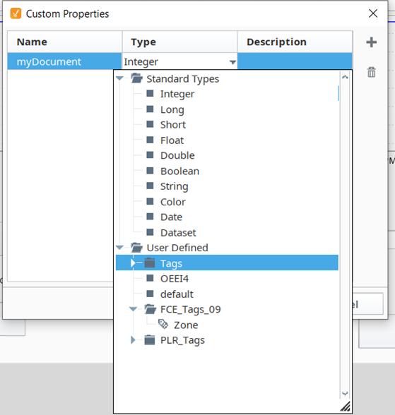

> Elsewhere, make an actual document type custom prop.
I don’t even see “document” as a valid property type in Vision.
 ![image](https://us1.discourse-cdn.com/inductiveautomation/original/3X/d/0/d08c01d3505c0ba86073b1b271ba7514e0a52db0.png)

`jsonEncode` is not an expression. It is a scripting function `system.util.jsonEncode()`.
Create a custom Document property on your window's root container to bind to the document tag. Then use a propertyChange script, filtering for the document property, to convert the document using `jsonEncode` and push the returned string into the Label.

Thank you, too, lrose.
Yes, I know it is a python script function 😄 and I did use that to write a string to the document tag, instead of a dict() because I’m a good try-er!
I still cannot select “document” as a data type for a custom property. Please post a pic if you can!
 ![image](https://us1.discourse-cdn.com/inductiveautomation/original/3X/f/3/f3d1b3a634d05617362c429a4f5ffba8dd549db1.png)
**Post date:** [September 18, 2025, 8:54pm UTC](https://forum.inductiveautomation.com/t/vision-labels-get-serialization-error-when-displaying-document-tag-values/110750/6 "2025-09-18T20:54:12Z")
What version of Ignition are you on?
This is from 8.1.48, not sure if they were added in 8.1.47 or .48
 ![image](https://us1.discourse-cdn.com/inductiveautomation/original/3X/7/1/7173770a1d6c2290730adfebf7764a45c30f6273.png)

**Post date:** [September 25, 2025, 7:09pm UTC](https://forum.inductiveautomation.com/t/vision-labels-get-serialization-error-when-displaying-document-tag-values/110750/7 "2025-09-25T19:09:00Z")
Thank you for the pic and sorry for the delay! I was on an all-expense paid vacation to visit some equipment.
The customer is using 8.1.33, which is for certain below 8.1.47.
I still don’t know why expressions choke when reading that tag type; that still feels ‘buggy’, but the workarounds abound, so wagons ho!
