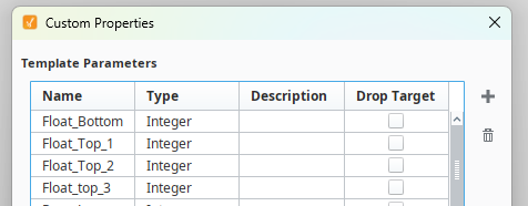

Ignition Vision Template
8.3.1
In Template custom properties,
I’ve defined several properties.
I am using Tank level NC/NO floats wired to a PLC to determine a value for tank fill level.
The If statement below works when I hard-code the float tag into the formula.
Well not really hared code it, pass it to another custom properties so I can edit the formula in designer
What I would like to do is use the custom properties to determine the float “number
I use the custom properties in the template and it will work in designer when I assign a number to the float.
The float icon color will change correctly based on if tank float is High or Low (1 or 0)
 ![Picture1](https://us1.discourse-cdn.com/inductiveautomation/original/3X/a/0/a0c36e8fbb2a5af09eb0f2f7664fad7bae1b8661.png)

If I try to use the “Template Custom Property” as a variable is will give me the error:
SCAN ERROR Nested Paths not allowed.
if(
{[Sample\_Tags]Floats/Float {Tank\_4Float\_2Pump (value).Float\_Top\_1}.value}=1,100,
if(
{[Sample\_Tags]Floats/Float 3.value}=1,75,
if(
{[Sample\_Tags]Floats/Float 2.value}=1,50,
if(
{[Sample\_Tags]Floats/Float 1.value}=1,25,0
There are several trends on “Nested path errors”
I tried several ways. Custom properties, template parameter tag, Internal properties tag.
I always get the same error. SCAN ERROR Nested Paths not allowed. (line1, char 31)

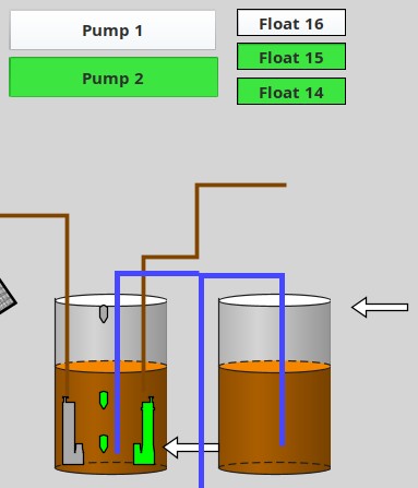

PS, Playing from home so I just made some memory tags to make toggling floats and pumps easier.
 ![Picture2](https://us1.discourse-cdn.com/inductiveautomation/original/3X/3/8/385dae23c43d11d98794bc25e1bf27da11f668c3.png)

Hi, I have a series of tanks, Grouped by 4 tanks thru an equalization pipe. Tank level is controlled by floats. only the first tank in each group of 4 has floats. There may or may not be pumps in each tank.
Used fill to display tank level but use floats to send it a fill level. I could have used a color block to show different levels of tank but not all tanks have 4 floats, some have 3 or less.
All float tags are numbered, by entering a float # and “1” in visible property, I can control which floats show level with out having a blank spot in tank if there were only 3 or 2 floats.
PS, I just made some memory buttons to toggle floats and punps.
 ![1](https://us1.discourse-cdn.com/inductiveautomation/original/3X/e/4/e42c890516305c102f88a573a2ce09f0d342b732.jpeg)
 ![2](https://us1.discourse-cdn.com/inductiveautomation/original/3X/5/1/51142d371389ec50863f965287e24053c78a85fb.jpeg)

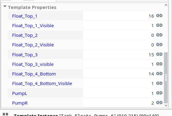

Same tank template
1st tank: setting floats 8,7,6,5 with visible set to 1’s Pumps set to 5 and 6
2nd tank: setting floats 8,7,6,5 with visible set to 0’s Pumps set to 7 and 8
3 rd and 4th tank: setting floats 8,7,6,5 with visible set to 0’s Pumps set to 0 and 0
This set of tanks has 2 tanks but only 3 floats for level.
Same template as above
1st tank : floats are 16,0,15 and 14 visible is 1,0,1,1 pump 1 and 2
2nd tank Floats are 16,0,15 and 14 visible is all set to 0 and pumps are set to 0

It is functioning as I would like it too after figured out the binding
