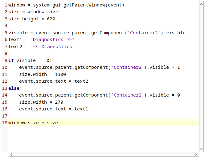

Good afternoon.
I’m trying to resize a window dynamically when pressing a button.
The resizing part is ok, but when I resize it, the container pushes its content to the right side.
How can I remove the green blank space between the window left edge and the content?

My button code is (mouse pressed event):
 ![image](https://us1.discourse-cdn.com/inductiveautomation/original/3X/0/2/0202507c8df0deff784aec6d15adb4d9e18ba08e.png)
Thanks.
**Author:** ![josborn](https://avatars.discourse-cdn.com/v4/letter/j/4bbf92/32.png) [@josborn](https://forum.inductiveautomation.com/u/josborn)\
**Post date:** [January 24, 2022, 10:55pm UTC](https://forum.inductiveautomation.com/t/vision-window-alignment/55311/2 "2022-01-24T22:55:21Z")
Check your container’s layout configuration. Relative Leading will make it stick to the the left side, but you will need to select which ever configuration works for you.
