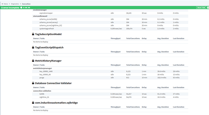

Thanks for the info, but what about the execution times? How long it takes to run through the tags in each tag group. Up to 8.1 or there abouts you could go to the gateway and see how long it took each tag group to run but that is gone now it appears unless it was moved somewhere else I am unable to locate.

I see this but not the durations.

If your tag group only has subscriptions, or expression tags in event mode, there is no overall duration to display. The tags update when subscriptions deliver new data, or expressions run individually on demand.

**Post date:** [July 7, 2025, 6:07pm UTC](https://forum.inductiveautomation.com/t/visualizing-tag-groups/108125/8 "2025-07-07T18:07:17Z")
Well, **zero** is the expected duration for subscriptions and event-triggered tags because those are no-ops for the group execution.

**Post date:** [July 7, 2025, 6:11pm UTC](https://forum.inductiveautomation.com/t/visualizing-tag-groups/108125/10 "2025-07-07T18:11:40Z")
You probably had some group or groups using OPC read mode instead of subscribed. That would show up the table you've found.

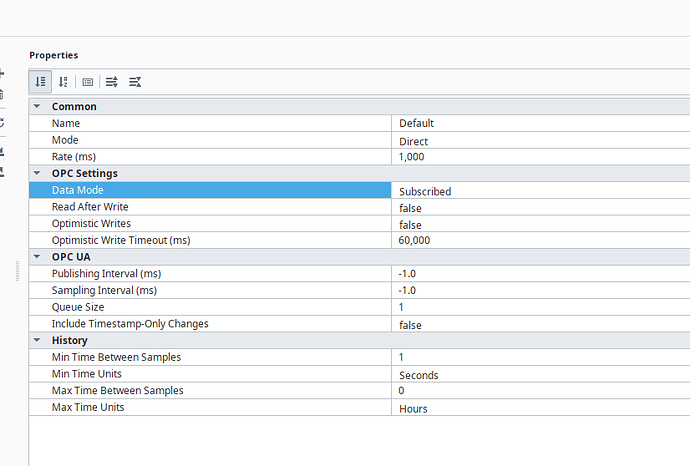

**Author:** ![CTrenkamp](https://sea1.discourse-cdn.com/inductiveautomation/user_avatar/forum.inductiveautomation.com/ctrenkamp/32/38440_2.png) [@CTrenkamp](https://forum.inductiveautomation.com/u/CTrenkamp)\
**Post date:** [July 7, 2025, 7:51pm UTC](https://forum.inductiveautomation.com/t/visualizing-tag-groups/108125/12 "2025-07-07T19:51:07Z")
Other than the rate and the name they are all set up the same and subscribed.

**Post date:** [July 7, 2025, 7:53pm UTC](https://forum.inductiveautomation.com/t/visualizing-tag-groups/108125/13 "2025-07-07T19:53:25Z")
> [@CTrenkamp](#):
> and subscribed.
Ok. I don't see anything that would make duration non-zero. 🤷‍♂️
**Post date:** [July 7, 2025, 8:12pm UTC](https://forum.inductiveautomation.com/t/visualizing-tag-groups/108125/14 "2025-07-07T20:12:02Z")
The only thing left in Ignition that might influence Tag Group "execution" and the last/avg duration columns you're looking at are expression tags in tag group execution mode.
Nothing else executes like this any more. Tag Groups don't execute tags or "go through" them or anything else like that.
