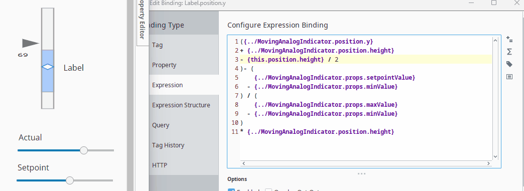

Hi,
I have one label and Moving Analog indicator which is having setpoint value dynamic .
Setpoint value and label value is same, so I want it to be in parallel position.
For visual clarity, I want label and diamond in same alignment.
I am using coordinate container for this.
is it possible to do this?
 ![image](https://us1.discourse-cdn.com/inductiveautomation/original/3X/a/c/ac677715d98b0c9817ca10d1e724d12f32ad627d.png)
**Post date:** [September 23, 2025, 4:16pm UTC](https://forum.inductiveautomation.com/t/want-to-set-label-alignment-to-moving-analog-indicator-setpoint/110894/2 "2025-09-23T16:16:24Z")
If you're looking for this,
 ![Moving analog indicator label](https://us1.discourse-cdn.com/inductiveautomation/original/3X/7/d/7dead578d3fba4cc5f002bab3c9bc95bcdb35f00.gif)
then create an expression binding on the label's `POSITION.y` property.
```python
({../MovingAnalogIndicator.position.y}
+ {../MovingAnalogIndicator.position.height}
- {this.position.height} / 2
	{../MovingAnalogIndicator.props.setpointValue}
  - {../MovingAnalogIndicator.props.minValue}
	{../MovingAnalogIndicator.props.maxValue}
* {../MovingAnalogIndicator.position.height}
Notice that the label position is correct in the centre but seems to move a little extra as the bounding container of the indicator is taller than the indicator itself. I'll leave you to modify the expression to fix that - if it bothers you.
