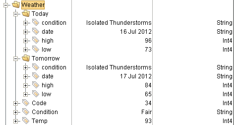

I was looking to get weather data without using regex. Turns out it is pretty easy. This is an almost copy/paste replacement for the weather script I have seen other places. This is also a good example to get started with pulling other XML feeds.
```auto
import xml.dom.minidom
#get the data
response = system.net.httpGet("http://xml.weather.yahoo.com/forecastrss?p=55012")
#put it in the dom
dom1 = xml.dom.minidom.parseString(response)
#get the tag for current conditions
for node in dom1.getElementsByTagName("yweather:condition"):
	#get the attributes, and write the tags
	system.tag.writeToTag("Weather/Condition",node.getAttribute("text"))
	system.tag.writeToTag("Weather/Code",node.getAttribute("code"))
	system.tag.writeToTag("Weather/Temp",node.getAttribute("temp"))
#the first forecast in the file is for today (there are two in this feed)
day = "Today"
#loop through the forecasts
for node in dom1.getElementsByTagName("yweather:forecast"):
	#get the attributes and write the appropriate tags
	system.tag.writeToTag("Weather/"+day+"/date",node.getAttribute("date"))
	system.tag.writeToTag("Weather/"+day+"/low",node.getAttribute("low"))
	system.tag.writeToTag("Weather/"+day+"/high",node.getAttribute("high"))
	system.tag.writeToTag("Weather/"+day+"/condition",node.getAttribute("text"))
	#the second time we loop through, write the data to the tomorrow folder
	day = "Tomorrow"
Need a tag structure like this:
 ![](https://us1.discourse-cdn.com/inductiveautomation/original/2X/7/72276a07544ed76dedb45c871b47fabf2cb8f2b5.png)

Anyone notice that Yahoo changed the forcast to 5 day. now the code in the script returns 4 days out not next day.
Thought this may work…
for node in dom1.getElementsByTagName(“yweather:forecast”)[1]:
But not…
**Author:** ![adamaustin](https://avatars.discourse-cdn.com/v4/letter/a/5f8ce5/32.png) [@adamaustin](https://forum.inductiveautomation.com/u/adamaustin)\
**Post date:** [July 2, 2013, 5:24pm UTC](https://forum.inductiveautomation.com/t/weather-without-regex/4827/14 "2013-07-02T17:24:56Z")
If you just want today’s forecast, then replace the entire for statement:
node = dom1.getElementsByTagName(“yweather:forecast”)[0]
```auto
day = "Today"
#get todays forecast
node = dom1.getElementsByTagName("yweather:forecast")[0]
