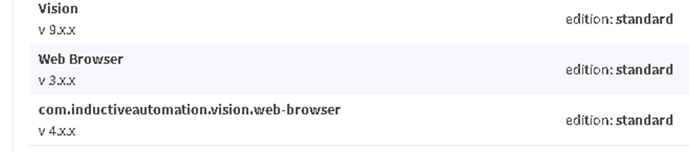

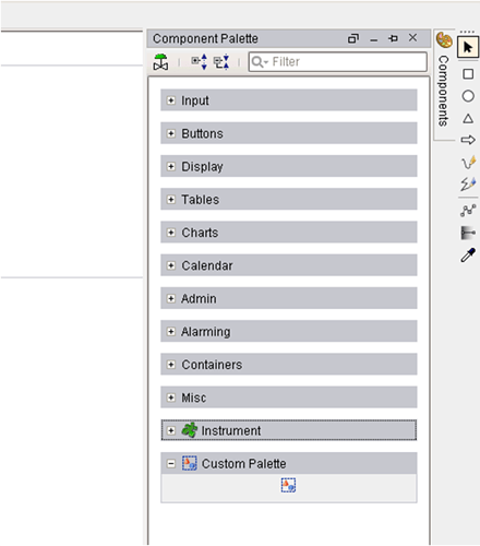

Hi.
I have a Ignition Gateway Version: 7.9.9 S.O. Windows Server 2008 | x86 32 bits
I install the web browser module (WebBrowser01) and install the licence for web browser module (WebBrowser02) but into the component palette (WebBrowser03) of the designer dont show the web browser component i search into each component groups (Input, buttons, display… Misc, Instruments, etc.).
Thanks
 ![WebBrowser01](https://us1.discourse-cdn.com/inductiveautomation/original/2X/2/2fdd35166475f7ad598c426238f14083f9f8bf15.png) ![WebBrowser02](https://us1.discourse-cdn.com/inductiveautomation/original/2X/e/ee62aa82f00fd43e411d754f8724d296429fe60d.png) ![WebBrowser03](https://us1.discourse-cdn.com/inductiveautomation/original/2X/d/d82032f8cbdd61df16727b85f3948cd965700131.png)
**Post date:** [January 9, 2020, 6:18pm UTC](https://forum.inductiveautomation.com/t/web-browser-component-dont-apper-into-component-palette-designer/31188/2 "2020-01-09T18:18:30Z")
Check the designer console on startup - are there any exceptions being logged about being unable to load the module? Are you sure your designer is pointed at the correct gateway with the web browser module?

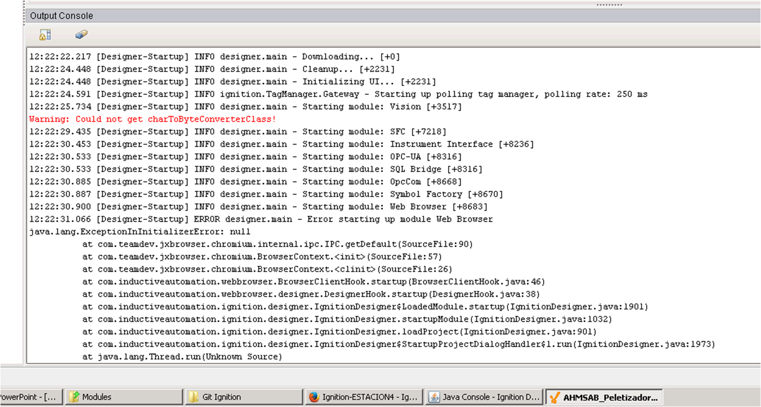

The console show this web browser module error Fig WebBrowser04
 ![WebBrowser04](https://us1.discourse-cdn.com/inductiveautomation/original/2X/4/4797efecbcde889b512451f1549617cf6ee7b9e2.png)
**Author:** ![GeraGarcia](https://sea1.discourse-cdn.com/inductiveautomation/user_avatar/forum.inductiveautomation.com/geragarcia/32/18471_2.png) [@GeraGarcia](https://forum.inductiveautomation.com/u/GeraGarcia)\
**Post date:** [January 9, 2020, 6:31pm UTC](https://forum.inductiveautomation.com/t/web-browser-component-dont-apper-into-component-palette-designer/31188/4 "2020-01-09T18:31:20Z")
12:22:31.066 [Designer-Startup] ERROR designer.main - Error starting up module Web Browser
java.lang.ExceptionInInitializerError: null
at com.teamdev.jxbrowser.chromium.internal.ipc.IPC.getDefault(SourceFile:90)
at com.teamdev.jxbrowser.chromium.BrowserContext.(SourceFile:57)
at com.teamdev.jxbrowser.chromium.BrowserContext.(SourceFile:26)
at com.inductiveautomation.webbrowser.BrowserClientHook.startup(BrowserClientHook.java:46)
at com.inductiveautomation.webbrowser.designer.DesignerHook.startup(DesignerHook.java:38)
at com.inductiveautomation.ignition.designer.IgnitionDesigner$LoadedModule.startup(IgnitionDesigner.java:1901)
at com.inductiveautomation.ignition.designer.IgnitionDesigner.startupModule(IgnitionDesigner.java:1032)
at com.inductiveautomation.ignition.designer.IgnitionDesigner.loadProject(IgnitionDesigner.java:901)
at com.inductiveautomation.ignition.designer.IgnitionDesigner$StartupProjectDialogHandler$1.run(IgnitionDesigner.java:1973)
at java.lang.Thread.run(Unknown Source)
Caused by: com.teamdev.jxbrowser.chromium.internal.EnvironmentException: Unsupported operating system. Supported OS: Windows 7 and higher, Windows Server 2008 R2 and higher, macOS 10.9 and higher, Linux. Current OS: Windows Server 2008, version: 6.0
**Post date:** [January 9, 2020, 6:38pm UTC](https://forum.inductiveautomation.com/t/web-browser-component-dont-apper-into-component-palette-designer/31188/5 "2020-01-09T18:38:17Z")
Looks pretty clear:
> [@GeraGarcia](#):
> Supported OS: Windows 7 and higher, Windows Server 2008 R2 and higher, macOS 10.9 and higher, Linux. **Current OS: Windows Server 2008, version: 6.0**
You need at least Server 2008 **R2**.
**Post date:** [January 9, 2020, 6:45pm UTC](https://forum.inductiveautomation.com/t/web-browser-component-dont-apper-into-component-palette-designer/31188/6 "2020-01-09T18:45:16Z")
Yes!!!. I think my client dont want to migrate the server version, bad for me, thanks.
**Post date:** [January 9, 2020, 6:48pm UTC](https://forum.inductiveautomation.com/t/web-browser-component-dont-apper-into-component-palette-designer/31188/7 "2020-01-09T18:48:24Z")
You should be able to run the designer on a different PC…
**Post date:** [January 9, 2020, 7:03pm UTC](https://forum.inductiveautomation.com/t/web-browser-component-dont-apper-into-component-palette-designer/31188/8 "2020-01-09T19:03:13Z")
If you _really_ can’t use a different designer, you can roll back to Web Browser Module to, I think, the 7.9.3 version, which uses an older version of the web browser library and should still work on your system.
**Post date:** [January 9, 2020, 7:06pm UTC](https://forum.inductiveautomation.com/t/web-browser-component-dont-apper-into-component-palette-designer/31188/9 "2020-01-09T19:06:27Z")
pturmel: But, the client could see the web browser control?, becouse i have the gateway in the same server with the windows 2008 version 6.0
thanks
**Post date:** [January 9, 2020, 7:08pm UTC](https://forum.inductiveautomation.com/t/web-browser-component-dont-apper-into-component-palette-designer/31188/10 "2020-01-09T19:08:46Z")
Yes, as long as the client PC was on a supported OS. Just like the suggestion for the designer. The Ignition gateway doesn’t have to support that component because the gateway doesn’t run any GUI itself.
