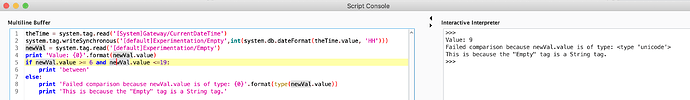

**Author:** ![cmallonee](https://sea1.discourse-cdn.com/inductiveautomation/user_avatar/forum.inductiveautomation.com/cmallonee/32/6416_2.png) [@cmallonee](https://forum.inductiveautomation.com/u/cmallonee)\
**Post date:** [July 7, 2020, 4:13pm UTC](https://forum.inductiveautomation.com/t/weird-comparison/36431/7 "2020-07-07T16:13:24Z")
Kevin is attempting to check the type of the tag you are reading/writing to because he suspects it is a String tag. I can’t explain why you found that one comparison works, but Kevin’s theory would explain the general issue:
 ![Screen Shot 2020-07-07 at 9.11.20 AM](https://us1.discourse-cdn.com/inductiveautomation/original/3X/c/f/cfee126679e423d46ff0cafb564b52fa07d3a3d5.png)
 ![Screen Shot 2020-07-07 at 9.13.39 AM](https://us1.discourse-cdn.com/inductiveautomation/original/3X/f/f/ffe42f7e9283652af3ae6ff4af8d2c66a387cb7d.png)
