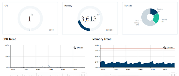

Hello everyone,
I have recently been investing some issues in a few of our gateways and have learned above some additional configuration settings within the Ignition.conf file see below:
```python
wrapper.java.additional.9=-Dignition.tags.expressionthreads=100
wrapper.java.additional.10=-Dignition.tags.scriptthreads=8
wrapper.java.additional.11=-Dignition.tags.scriptqueuemaxsize=20
wrapper.java.additional.12=-Dignition.tags.db_tag_threads=6
wrapper.java.additional.13=-Dignition.sqlbridge.maxthreads=5
I believe all the of the writing below is what each additional config value controls.
**Tag Value Change Scripts:**
wrapper.java.additional.1=-Dignition.tags.scriptthreads=5
wrapper.java.additional.2=-Dignition.tags.scriptqueuemaxsize=10
**Expression:**
wrapper.java.additional.1=-Dignition.tags.expressionthreads=10
**SQL Transaction groups specifically:**
wrapper.java.additional.1=-Dignition.sqlbridge.maxthreads=10
**QueryTags:**
wrapper.java.additional.1=-Dignition.tags.db\_tag\_threads=10
I have a few questions/clarifications:
After increasing all of these limits the first thing I had to do was increase the DB connection pool. I started the server and noticed that the DB kept faulting so I did an increase from 8 Max connections to 50 which is running very good now.
I’m assuming this is due to more scripts/expressions/other items executing at a faster rate therefore taking up active DB connections instead of waiting to execute.

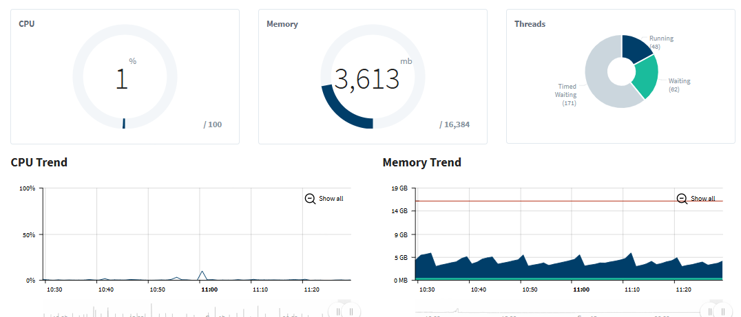

This is my performance change:
**After changes:**
 ![image](https://us1.discourse-cdn.com/inductiveautomation/original/3X/8/0/80d58651fe3212ea178ecee98436cb81fd81426d.png)
Threads drop back down as well:
it seems like the average is ~58-100
**Before Changes:**
 ![image](https://us1.discourse-cdn.com/inductiveautomation/original/3X/f/4/f4fe55bd14b731067cd08908ec04275a5caf82f6.png)
I’ve also noticed that my tags/udts in the gateway browser now change instantly before the changes I would change a value/expression and it would take ~1 Minute + to set that value or execute the expression.
**With all of this information I have a few questions:**
#1 Am I going in the right direction with these .conf additions.
#2 Are threads directly related to CPU threads when I set my x\_threads property if so why is my CPU performance still super low I want to make the most of my server and it seems like the CPU is not really being touched here.
#3 Any other advanced details or settings to help me further increase my gateway performance would be very helpful!
Additional details about this project specifically:
Full Perspective Project
We use many different UDTs that perform calculations such as:
1. A Large amount of expression tags:
  1. Simple logic expression tags
  2. Advanced runscript() tags (These scripts are optimized for maximum performance)
2. Reference Tags
3. Memory Tags
4. Query Tags
  1. A majority of query tags execute stored procedures rather than raw query statements.
All tags are setup with different tag groups with the fastest being 1 second and the slowest being around 30 minutes.
Any insights are greatly appreciated, thank you in advanced!
**Post date:** [September 15, 2025, 4:31pm UTC](https://forum.inductiveautomation.com/t/what-are-best-practices-for-advanced-gateway-performance-threads-db-pooling-tag-performance-etc/110625/2 "2025-09-15T16:31:57Z")
> [@Noah\_Casey](#):
No. That will reduce thread starvation incidents in these subsystems, but will not reduce the actual workload of your system. Patches a few pinholes in the stern of your ocean liner while an iceburg has ripped a huge gash in your bow.
> [@Noah\_Casey](#):
No. Ignition is massively multithreaded anyways. The `.conf` settings are for applications with hundreds of thousands or millions of tags where the single-digit milliseconds rule doesn't suffice.
> [@Noah\_Casey](#):
Unless you mean these scripts run in a few milliseconds, without inducing **any** network traffic (OPC, DB, web API), I am skeptical.
> [@Noah\_Casey](#):
> Query Tags
Yeah, no. Don't do this. Make a single timer or scheduled event that runs all of the necessary queries, one at a time, and writes the results to same-named memory tags.
Any tag valueChange events and/or runScript invocations that need to reach out to a DB or OPC or web API need to be moved to gateway events in the project.
**Post date:** [September 15, 2025, 6:18pm UTC](https://forum.inductiveautomation.com/t/what-are-best-practices-for-advanced-gateway-performance-threads-db-pooling-tag-performance-etc/110625/3 "2025-09-15T18:18:31Z")
> [@Noah\_Casey](#):
Generally, no. These configuration knobs exist for a reason, but these are **wildly** different subsystems. The correct answer to "a performance problem" is to fix that one performance problem, not shotgun a variety of things and blindly hope they fix the (unspecified) issue. For one thing, even _if_ you end up fixing an issue, you'll have no idea **which** thing you did fixed it.
> [@Noah\_Casey](#):
Suffice it to say that there is no secret `-DrunIgnitionFast=true` parameter. The defaults are defaults for a reason, and it is much better to analyze a specific problem and derive a specific solution to that problem than cargo-cult what you can find here on the forums.
Your two performance graphs are **not** dramatically different, and neither really indicate a system I'd deem a pressing concern. As Phil said, application code errors are a much more likely root cause, which you have likely only band-aided over. There is no configuration parameter that can prevent a sufficiently motivated actor from crippling an Ignition gateway, guaranteed.
