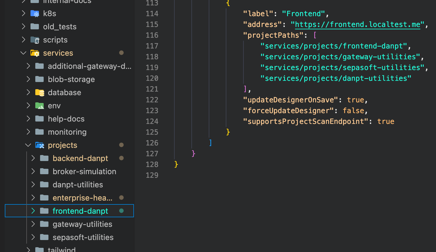

**Author:** ![aaronrai24](https://sea1.discourse-cdn.com/inductiveautomation/user_avatar/forum.inductiveautomation.com/aaronrai24/32/87248_2.png) [@aaronrai24](https://forum.inductiveautomation.com/u/aaronrai24)\
**Post date:** [October 16, 2025, 3:13pm UTC](https://forum.inductiveautomation.com/t/what-external-tools-do-you-use-for-ignition-development-and-why/93759/78 "2025-10-16T15:13:02Z")
@louagejasper the projectPaths should be the relative path where your ignition project is in your file system(check screenshot). If you go to Help\>Toggle Developer Tools in VSCode you can see a console, this is helpful for debugging if the project update is being sent or erroring out. Can you try opening that console and then saving in a project library script and see if any errors are logged?
 ![image](https://us1.discourse-cdn.com/inductiveautomation/original/3X/e/2/e2726dfe1371a84f17b56d9bb73a2a6ad4e508ea.png)
**Author:** ![louagejasper](https://sea1.discourse-cdn.com/inductiveautomation/user_avatar/forum.inductiveautomation.com/louagejasper/32/86311_2.png) [@louagejasper](https://forum.inductiveautomation.com/u/louagejasper)\
**Post date:** [October 17, 2025, 1:56pm UTC](https://forum.inductiveautomation.com/t/what-external-tools-do-you-use-for-ignition-development-and-why/93759/79 "2025-10-17T13:56:25Z")
Thanks for your reply!
What if I want to just open the project folder, what would be the path if I am in the project folder?
I tried "", "/", but no success:
 ![image](https://us1.discourse-cdn.com/inductiveautomation/original/3X/a/b/abd2e4168c2ba954af16413e1c6faa426539e3d7.png)
I also tried to put .vscode in a parentfolder, and put this in:
```python
    "ignitionFlint.sslVerify": false,
    "ignitionFlint.ignitionGateways": [
            "label": "local",
            "address": "http://localhost:8088",
            "projectPaths": [
              "/ignition-data/projects/proferro"
            "updateDesignerOnSave": true,
            "forceUpdateDesigner": true,
            "supportsProjectScanEndpoint": true
But that gave the same results.
