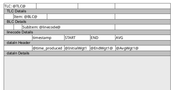

I threw this together to get you started. It may not be exactly what you want, but again , just to get you started.
Using a scripted data source in the report:

Here is the page layout
 ![image](https://us1.discourse-cdn.com/inductiveautomation/original/3X/9/6/9658acacbb0d541d96f205e2d5862acd004627cb.png)
grouping below, dataIn has `Header` and `Details` the rest just `Details` checked. For the BLC grouping, `Page Break` is selected.
 ![image](https://us1.discourse-cdn.com/inductiveautomation/original/3X/9/f/9fb3ef83a992d898f3b86aaf5794a107afb88dcf.png)

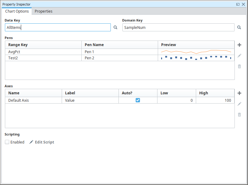

I’m trying to add a graph at the bottom using the @AvgPct@ from my list, but it’s showing two data points for each X 1-19 on the chart. One is for item1 (Mushrooms) and the other is for item2 (Onions).
I have the chart in the AllItems Summary section of the table.
I’m using SampleNum which has the correct number of samples taken, 19 as my Domain Key.
AvgPct is the number shown on the right column of the table directly above the chart. AllItems is my only data source.
 ![image](https://us1.discourse-cdn.com/inductiveautomation/original/3X/7/a/7a35e8dc9943e72ccec969ed97b8732e1108c1c3.png)

In my experience, I always have a separate data source for charts to make sure it gets the exact data and format it needs to render the way I want. Review the dataset structuring needed for the chart in the user manual carefully.
