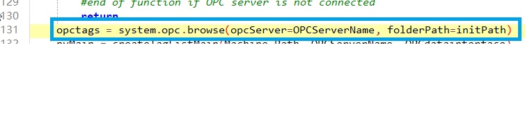

when I update my tags using script
 ![err](https://us1.discourse-cdn.com/inductiveautomation/original/3X/e/b/eb37c231e60ab75798916cec5b0ab4c6bcdade06.jpeg)
,error show up like this :
Traceback (most recent call last):
File "event:actionPerformed", line 15, in
File "module:GSD\_ADM\_Addressing.S71200", line 131, in addressTags

com.inductiveautomation.ignition.client.gateway\_interface.GatewayException: com.inductiveautomation.ignition.client.gateway\_interface.GatewayException: Read timed out

**Post date:** [November 2, 2023, 11:49am UTC](https://forum.inductiveautomation.com/t/when-use-system-opc-browse-error/81356/2 "2023-11-02T11:49:20Z")
Your browse operation is unable to complete in the 60 seconds allowed for gateway RPC calls. You will need to perform this operation in small, non-recursive chunks, and/or run it in a gateway script (to not have the timeout). Browse operations are expensive, so you should save the results somewhere for later callers to re-use.
