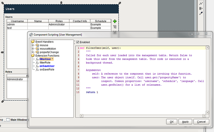

Ok diat150 and RRRancher - in beta-6 we’ve introduced extension functions. On the user admin component these will let you insert your own logic to filter the user/role lists down based on who is currently logged in. There are also hooks for when the save button is pressed. Here’s a sneak peek:
 ![](https://us1.discourse-cdn.com/inductiveautomation/original/2X/f/f1933ebf09adba60a11e783fc6fe40808f6d375b.PNG)
The table component got some too. I imagine we’ll add more of these as we think of good ideas for them.

I just had a chance to try the Extension Functions for the Roster Management. While I can use these functions to do what I need to, I’m not sure the best way to go about it.
We are currently using database security and have a lot of time and effort into custom tables and queries. This is mainly to break users into organizational groups similar to what RRRancher mentioned. Supervisors of these groups will only be concerned about a specific roster and a group of users that they manage.
I can use the filterRoster to limit the roster to what they need, but a property that works like the User Source would be easier. I can use the filterAvailableUser to run a query on each user and see if they are in the group that the supervisor manages, or check to see if they have a specific role. I’m concerned that the larger our system gets the slower this approach will be. Being able to run a query to get a list of Available Users would easier.

I have been doing some testing with the new management components using an AD Internal Hybrid user source. There is one major thing missing that is preventing me from using this type user source.
When using the User Management component, there is no way I can see to know when a user is deleted. If a new user is added, or if I modify a user, the onSaveUser function is triggered, and scripting can accomplish anything else needed. But If I delete a user, nothing is triggered, so I have no way to run a script to remove that user’s records from various tables. Seems like an onDeleteUser extension function would be easy to add to the User Management component.
