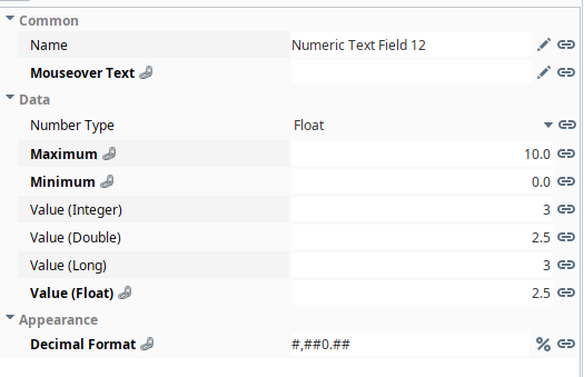

I have a number of Numeric Text fields in my project. Yesterday the suffix and many other options in disappeared from the Property Editor
 ![image](https://us1.discourse-cdn.com/inductiveautomation/original/3X/d/7/d76fb08339e2b9a6a608eb606ef52907003ce5b4.png)
any clues how I can get them back?

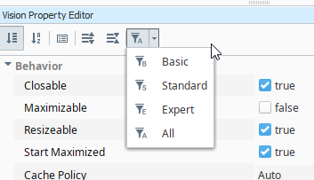

![image](https://us1.discourse-cdn.com/inductiveautomation/original/3X/0/6/0624512b2e9206aa58d3e1378cd1f0479a32bbe8.png)
**Author:** ![Brad\_Niemi1](https://avatars.discourse-cdn.com/v4/letter/b/ecd19e/32.png) [@Brad\_Niemi1](https://forum.inductiveautomation.com/u/Brad_Niemi1)\
**Post date:** [February 27, 2024, 1:37pm UTC](https://forum.inductiveautomation.com/t/where-did-my-suffix-go/86430/3 "2024-02-27T13:37:52Z")
thanks, not sure how I bumped that
