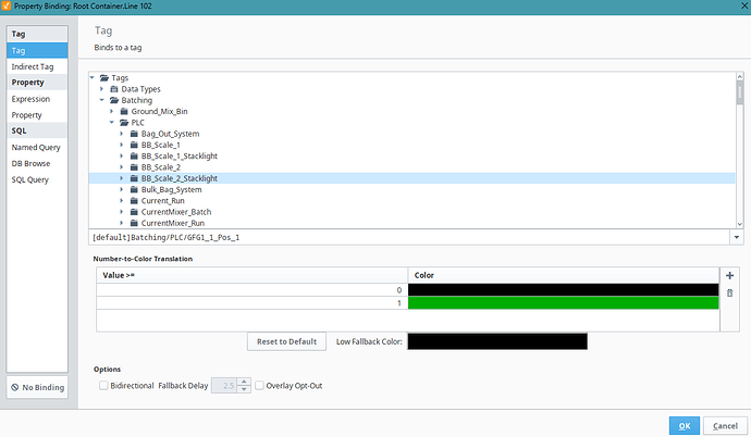

I get this alarm.
 ![image](https://us1.discourse-cdn.com/inductiveautomation/original/3X/3/7/371aef96e790066235e29343cb328c7c146f18aa.png)
**Post date:** [August 21, 2025, 3:45pm UTC](https://forum.inductiveautomation.com/t/whey-doesnt-this-expression-work-in-vision/110048/4 "2025-08-21T15:45:34Z")
It means your binding is to a component property that is not a boolean.
**Author:** ![cssbrn](https://avatars.discourse-cdn.com/v4/letter/c/db5fbb/32.png) [@cssbrn](https://forum.inductiveautomation.com/u/cssbrn)\
**Post date:** [August 21, 2025, 3:49pm UTC](https://forum.inductiveautomation.com/t/whey-doesnt-this-expression-work-in-vision/110048/5 "2025-08-21T15:49:14Z")
I am trying to change a color using two bools. How do I make this work?
 ![image](https://us1.discourse-cdn.com/inductiveautomation/original/3X/f/b/fbe55a8774a6bf0e6fa1031f94d12169501f9bc0.png)
**Post date:** [August 21, 2025, 3:51pm UTC](https://forum.inductiveautomation.com/t/whey-doesnt-this-expression-work-in-vision/110048/6 "2025-08-21T15:51:53Z")
Vision doesn't have transforms for expressions. You will need to either wrap your expression in `if()` and return deliberate colors with `toColor()`, or place that expression on a custom boolean property and use styling.
**Post date:** [August 21, 2025, 3:52pm UTC](https://forum.inductiveautomation.com/t/whey-doesnt-this-expression-work-in-vision/110048/7 "2025-08-21T15:52:15Z")
## Option 1
1. Add a custom property (type: boolean) to your component.
2. Use the same expression binding you already have to return a true/false result.
3. Use the style customizer on the component, using your custom property as the 'driving' property, to affect the styles.
## Option 2
Use a more complex expression using the `toColor` function to return an actual color.
```python
toColor(
    if({tag1} && {tag2}, "00FF00", "000000")
**Post date:** [August 21, 2025, 3:53pm UTC](https://forum.inductiveautomation.com/t/whey-doesnt-this-expression-work-in-vision/110048/8 "2025-08-21T15:53:17Z")
Thank you.
