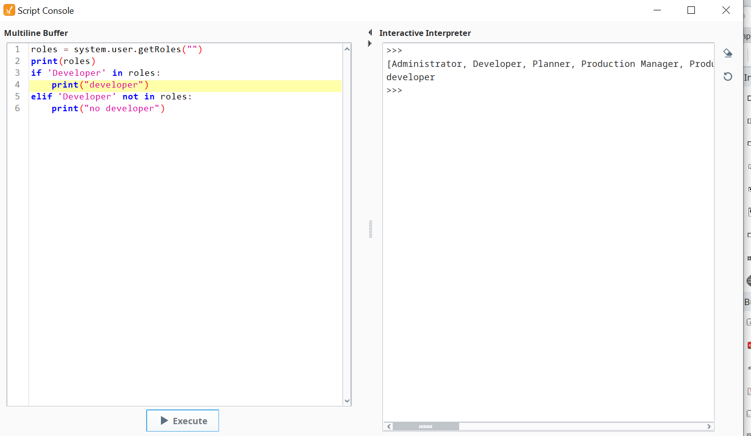

**Author:** ![Dharani\_T](https://avatars.discourse-cdn.com/v4/letter/d/bc8723/32.png) [@Dharani\_T](https://forum.inductiveautomation.com/u/Dharani_T)\
**Post date:** [June 13, 2023, 9:15am UTC](https://forum.inductiveautomation.com/t/which-user-only-supervisor-role/74941/6 "2023-06-13T09:15:16Z")
Can u provide the results of print(roles)
check out this:
 ![image](https://us1.discourse-cdn.com/inductiveautomation/original/3X/3/c/3c5792d3dc309e42504959710a5d1e595b453528.png)
**Post date:** [June 13, 2023, 9:26am UTC](https://forum.inductiveautomation.com/t/which-user-only-supervisor-role/74941/8 "2023-06-13T09:26:48Z")
You meant to say, switch user must be enabled only if the user has supervisor role (only 1 role)?
