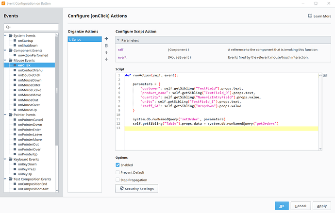

I am working on the ignition gold cert practice test. I ran into an odd error where the value of my staff\_id dropdown does not seem to be passing correctly. I am running this script:
 ![image](https://us1.discourse-cdn.com/inductiveautomation/original/3X/1/c/1c392431b6395181e2804d01dea7f935d51bdd2e.png)
and getting this error:
 ![image](https://us1.discourse-cdn.com/inductiveautomation/original/3X/5/1/51497688ee2206611de2b9a575337e9b9966f93d.png)
It seems to be truncating the value to the first character, but I can’t figure out why. The data type in the database is varchar like the other strings:
 ![image](https://us1.discourse-cdn.com/inductiveautomation/original/3X/3/1/315892ee81261ace8e7db0acd22935727e31d8ba.png)
What am I missing?

The varchar type has a length associated with it, so I'm guessing you have it defined as length 1.
**Author:** ![Rob\_Lapkass](https://avatars.discourse-cdn.com/v4/letter/r/e95f7d/32.png) [@Rob\_Lapkass](https://forum.inductiveautomation.com/u/Rob_Lapkass)\
**Post date:** [October 6, 2025, 5:47pm UTC](https://forum.inductiveautomation.com/t/why-do-strings-from-a-dropdown-component-get-truncated-in-sql-query/111218/3 "2025-10-06T17:47:21Z")
Hi Daniel: have another look at the prompt for the staff\_id field datatype, it is listed as an INT to correlate with the user source users table.
