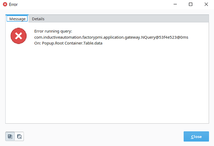

When I try to bind it to a table, I get this error:
 ![image](https://us1.discourse-cdn.com/inductiveautomation/original/3X/8/9/89785cb806ccf46d1b58a0530947d66c28f8a6a0.png)
 ![image](https://us1.discourse-cdn.com/inductiveautomation/original/3X/d/c/dcefef30b2ae84d62ca46545ad1a50b793955b23.png)
 ![image](https://us1.discourse-cdn.com/inductiveautomation/original/3X/a/5/a57f94537c49c0c3d676850d82c63d09b8c3e804.png)
Why would it work in testing, but not on a binding?
**Author:** ![bschroeder](https://sea1.discourse-cdn.com/inductiveautomation/user_avatar/forum.inductiveautomation.com/bschroeder/32/13260_2.png) [@bschroeder](https://forum.inductiveautomation.com/u/bschroeder)\
**Post date:** [August 1, 2025, 1:23pm UTC](https://forum.inductiveautomation.com/t/why-does-this-query-work-in-testing-but-not-when-i-try-to-populate-a-table/109249/2 "2025-08-01T13:23:16Z")
On the error popup there is a link to the full error. Can you click that and then copy and paste it properly formatted here? There might be more information in that error that will help.

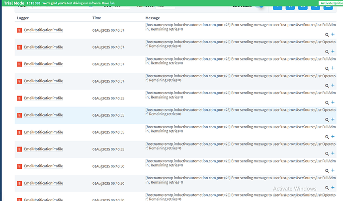

I'm not seeing one, just a bunch of errors from the email notification pipeline I created:
 ![image](https://us1.discourse-cdn.com/inductiveautomation/original/3X/a/e/ae754c0cc588eacade6384d5c89bef11e5e58e1f.png)
I scrolled to where the error would be, and did not see anything other than more of these
**Post date:** [August 1, 2025, 1:43pm UTC](https://forum.inductiveautomation.com/t/why-does-this-query-work-in-testing-but-not-when-i-try-to-populate-a-table/109249/8 "2025-08-01T13:43:44Z")
Try turning off the noisy logger then running the table query again.
(You are trying to send email through IA's servers, so of course that part doesn't work. 🙄 )

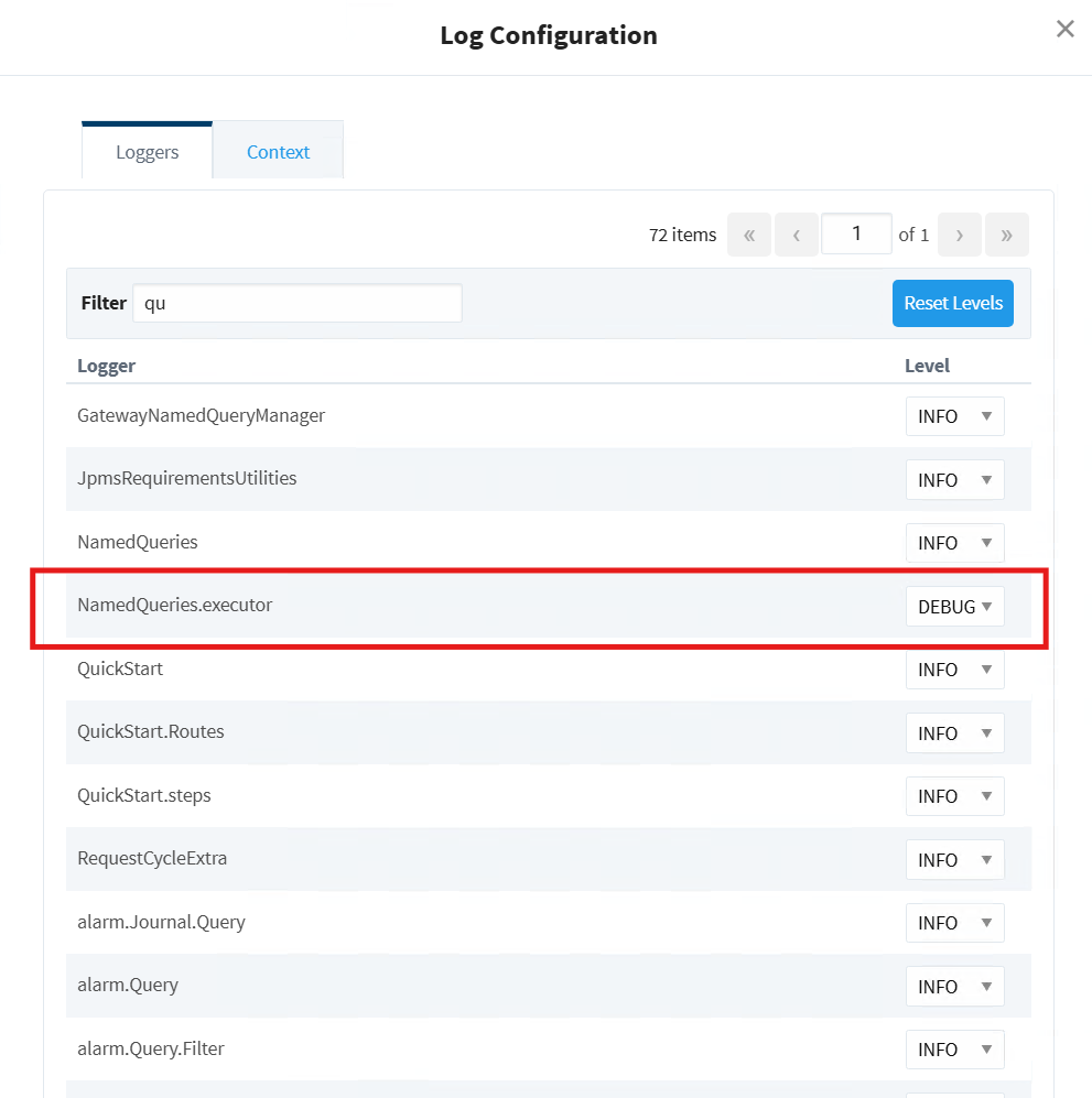

You may need to enable DEBUG logging on named query execution. (I don't know the logger names off the top of my head--search in the logger level controls.)
**Author:** ![Daniel\_Whitlock](https://avatars.discourse-cdn.com/v4/letter/d/8edcca/32.png) [@Daniel\_Whitlock](https://forum.inductiveautomation.com/u/Daniel_Whitlock)\
**Post date:** [August 1, 2025, 1:56pm UTC](https://forum.inductiveautomation.com/t/why-does-this-query-work-in-testing-but-not-when-i-try-to-populate-a-table/109249/13 "2025-08-01T13:56:17Z")
this right?
 ![image](https://us1.discourse-cdn.com/inductiveautomation/original/3X/7/8/780039ec4b6b1439488149f5034aeb2a8f1efc2a.png)
**Post date:** [August 1, 2025, 1:58pm UTC](https://forum.inductiveautomation.com/t/why-does-this-query-work-in-testing-but-not-when-i-try-to-populate-a-table/109249/14 "2025-08-01T13:58:27Z")
Yep, and/or the one above it.

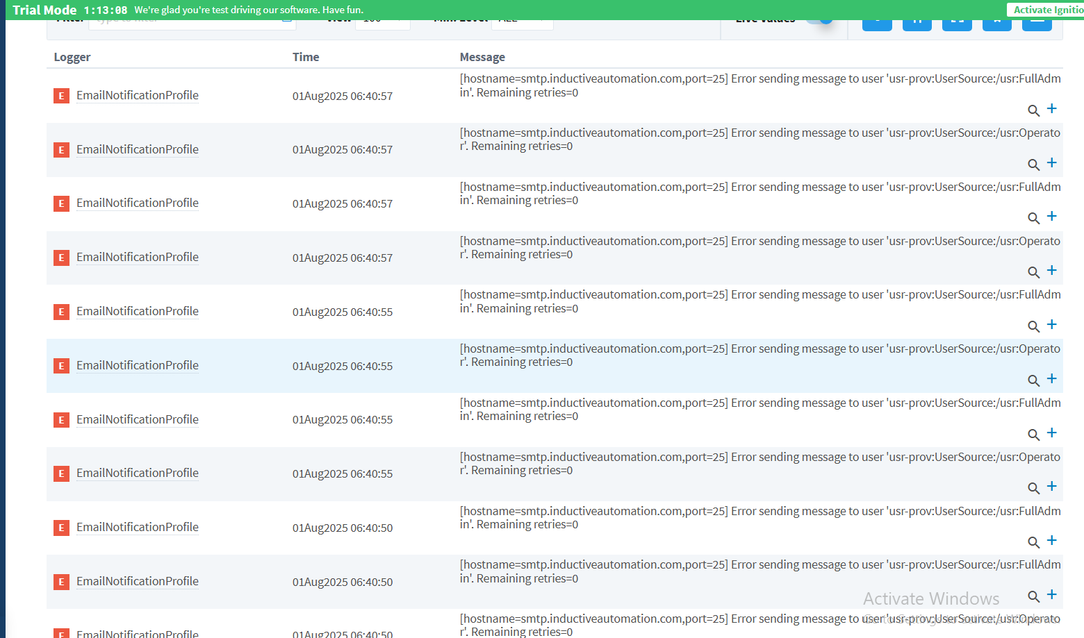

I'm still not getting any error information on the gateway. This is all I'm seeing:
 ![image](https://us1.discourse-cdn.com/inductiveautomation/original/3X/1/0/1096a5f2be160f669857e144e1d2911dd04781b0.png)
**Post date:** [August 1, 2025, 2:03pm UTC](https://forum.inductiveautomation.com/t/why-does-this-query-work-in-testing-but-not-when-i-try-to-populate-a-table/109249/16 "2025-08-01T14:03:22Z")
In that error box, there are other errors. Do any of them pertain to this query? Is there anything in the Designer Console?
