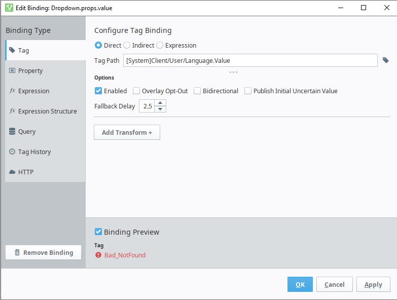

Hello,
Why Ignition Edge cannot access to system provider? I am trying to bind a perspective label with the user language at **"[System]Client/User/Language.Value"** but the value is Bad\_NotFound.
 ![Screenshot 2024-07-10 105317](https://us1.discourse-cdn.com/inductiveautomation/original/3X/e/c/ecbbfb66646b47908dcc18670cd4be1771e6161f.jpeg)
**Author:** ![Hayden\_Watson](https://sea1.discourse-cdn.com/inductiveautomation/user_avatar/forum.inductiveautomation.com/hayden_watson/32/48792_2.png) [@Hayden\_Watson](https://forum.inductiveautomation.com/u/Hayden_Watson)\
**Post date:** [July 10, 2024, 8:59am UTC](https://forum.inductiveautomation.com/t/why-ignition-edge-cannot-access-to-system-provider/92996/2 "2024-07-10T08:59:30Z")
Client tags are only for the vision module not perspective, you'll need to check the session props for this kind of information

How can i then get the user language in perspective ?
**Post date:** [July 10, 2024, 9:19am UTC](https://forum.inductiveautomation.com/t/why-ignition-edge-cannot-access-to-system-provider/92996/4 "2024-07-10T09:19:08Z")
_session.props.locale_ should do it.

Is _session.props.locale_ related automatically to connected user ? or it is the default gateway language ?
I want that if the user changes the language, it will be stored for all futur sessions, the user should not change the language at every session start.
**Post date:** [July 10, 2024, 9:34am UTC](https://forum.inductiveautomation.com/t/why-ignition-edge-cannot-access-to-system-provider/92996/6 "2024-07-10T09:34:56Z")
It gets it from however it is set up in the project properties. If you want it as a user setting, then store the preference in a db table and reading it upon start.

Yes, but we cannot write in DB in ignition Edge.
**Post date:** [July 10, 2024, 9:43am UTC](https://forum.inductiveautomation.com/t/why-ignition-edge-cannot-access-to-system-provider/92996/8 "2024-07-10T09:43:05Z")
Sorry, didn't pay attention to that part. 😉
Then you are limited to using a dataset or document tag.
