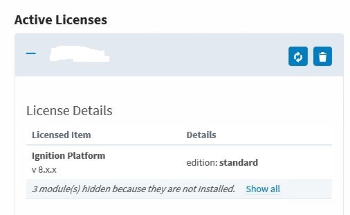

I just installed a new pc with Ignition and got the license activated using a file and for some reason, it is still in the trial state. Why this computer does not do like the 30 others. I fail to understand the reason for that, there should be 4 module that are registered with that license key.

Do look at the licensing page on your gateway, expanding the license you think you have. (A screenshot might help, but _ **don’t** _ show us your license key.)
**Author:** ![patrick.garceau](https://avatars.discourse-cdn.com/v4/letter/p/76d3ee/32.png) [@patrick.garceau](https://forum.inductiveautomation.com/u/patrick.garceau)\
**Post date:** [September 24, 2019, 12:24pm UTC](https://forum.inductiveautomation.com/t/why-would-ignition-not-activate-a-license/28501/5 "2019-09-24T12:24:33Z")
![Capture](https://us1.discourse-cdn.com/inductiveautomation/original/2X/a/a32808c2d8c98d1a44952e9721a3ab9f3b563a49.jpeg)
What does that mean, not installed?
**Author:** ![grietveld](https://sea1.discourse-cdn.com/inductiveautomation/user_avatar/forum.inductiveautomation.com/grietveld/32/6984_2.png) [@grietveld](https://forum.inductiveautomation.com/u/grietveld)\
**Post date:** [September 24, 2019, 12:26pm UTC](https://forum.inductiveautomation.com/t/why-would-ignition-not-activate-a-license/28501/6 "2019-09-24T12:26:51Z")
Hitting show all might give a bit more information, but it could be the license is for different versions than are installed, or those specific modules weren’t configured on that machine.
You should be able to address it by pulling the modl files from IAs download page, or re-running the installer.

The license you are showing is for very limited duty as an OPC server for Modbus devices and generic TCP/UDP devices, not a typical install of Ignition. ($150 per IA’s [pricing tool](https://inductiveautomation.com/pricing/ignition).) What modules are actually installed?

Looks like a v8 license with a v7.9 install. Might be a bug related to that. Look at your other gateway’s licenses.

Is this the first of the nine installs? You might need a special license from IA if you are installing v7.9 with plans to switch to v8 later. Mainly because the module “name” code in licenses changed for some modules between v7.9 and v8. You’ll need help from your salesperson if you are installing all of these as v7.9.
**Post date:** [September 24, 2019, 1:39pm UTC](https://forum.inductiveautomation.com/t/why-would-ignition-not-activate-a-license/28501/18 "2019-09-24T13:39:59Z")
This is a 7.9 gateway with a license for version 8.x installed. If you’re not supposed to be running 8.0.x then call your sales rep and have them fix up the license.

I have used the 7.9.10 version since the beginning, if there is a new installation, I can get the new download and try this.
Looking at another site, everything looks the same except that it says Activated.
Let me try to download a new release and try
**Post date:** [September 24, 2019, 1:44pm UTC](https://forum.inductiveautomation.com/t/why-would-ignition-not-activate-a-license/28501/20 "2019-09-24T13:44:00Z")
> [@patrick.garceau](#):
Then the version numbers and module names in the license file for those gateways would be different. Again, your salesperson can help. (If you do one as v8, I'd recommend doing all nine as v8.)
