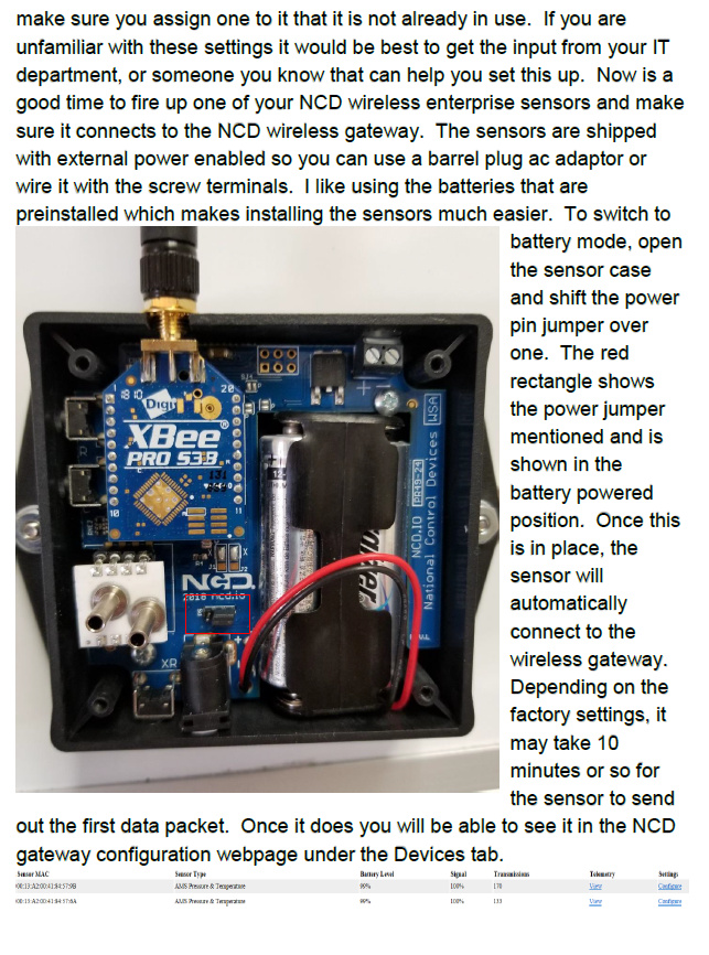

I just finished this tutorial on how to setup a wireless MQTT based sensor network using hardware from [NCD.io](http://NCD.io) and the Cirrus Link MQTT modules for Ignition. You can check it out [here](https://community.ncd.io/t/wireless-mqtt-sensors-from-ncd-for-ignition-scada-tutorial/4250). The file was to large to upload in this forum even after compressing. ☹
