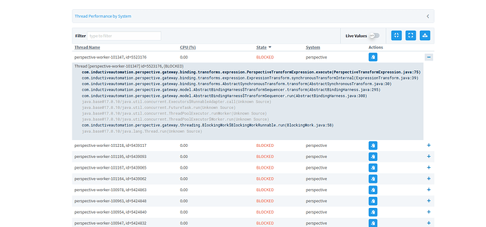

![Gateway_performance_issue](https://us1.discourse-cdn.com/inductiveautomation/original/3X/d/c/dceabb6678d1ebfb93f41facc9f893f95c765867.png)
 ![Gateway_Performance_issue2](https://us1.discourse-cdn.com/inductiveautomation/original/3X/4/b/4b123c45aac5db10bf38d12238f642e83fbfce76.png)
As the error is displaying, we need help to find which exact project and view is causing the thread to go in block state when the perspective sessions are open (Ignition Version - 8.1.41)
**Post date:** [August 8, 2025, 12:50pm UTC](https://forum.inductiveautomation.com/t/within-the-open-perspective-sessions-few-bindings-are-causing-the-blocked-threads-to-increase-which-is-then-causing-the-gateway-restart/109530/2 "2025-08-08T12:50:13Z")
You should download a thread dump from your gateway. If you don’t know how to analyze it, you should open a support ticket for help.
