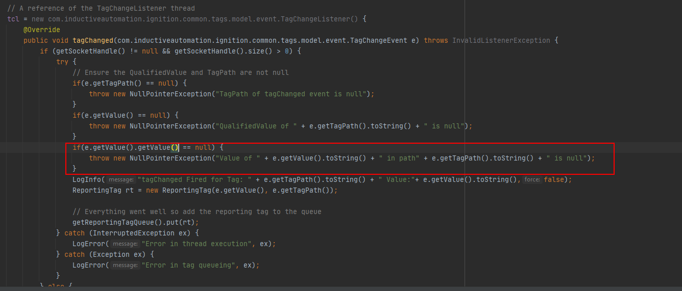

**Author:** ![wci.jgiese](https://sea1.discourse-cdn.com/inductiveautomation/user_avatar/forum.inductiveautomation.com/wci.jgiese/32/50225_2.png) [@wci.jgiese](https://forum.inductiveautomation.com/u/wci.jgiese)\
**Post date:** [October 22, 2020, 5:11pm UTC](https://forum.inductiveautomation.com/t/working-to-understand-and-find-the-concurrent-modification-exception/39919/4 "2020-10-22T17:11:06Z")
FINALLY I FOUND THE NULL POINTER ISSUE! Throw enough (a gross amount) of try catches at the wall something will stick I guess.
Turns out when I see these it’s because the tagChanged events qualified value’s value object returns a null value event.[QualifiedValue]getValue().[Object]getValue()
 ![image](https://us1.discourse-cdn.com/inductiveautomation/original/3X/6/8/68a67a23e05a3acf984880f4d386ede5c4ab3f5a.png)
Wowza that was obnoxious ha ha ha!
The concurrent errors appear to have gone away. Not sure if that’s because of the change in the for loop or that we threaded the message sending in a blocking queue outside the tagChanged event. Regardless both needed to be done.
Lesson here, if anyone hooks tagChanged to use the actual value value of the qualified value, make sure it’s not null before you try to use it 😃

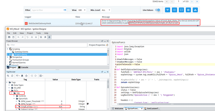

**Post date:** [October 22, 2020, 5:47pm UTC](https://forum.inductiveautomation.com/t/working-to-understand-and-find-the-concurrent-modification-exception/39919/5 "2020-10-22T17:47:18Z")
So… I tried fixing it up stream by not allowing it to resolve to null. But this query tag is still sending null through tagChanged. Anyone with insight as to why that might be happening.
 ![image](https://us1.discourse-cdn.com/inductiveautomation/original/3X/0/8/088811271633a3387d45ed1c158d9d745305df62.png)
That null exception is being caught here in the hook
 ![image](https://us1.discourse-cdn.com/inductiveautomation/original/3X/a/2/a2500acd3077b7921ec8034bdd36437d9fee4cdd.png)
**Post date:** [October 22, 2020, 5:56pm UTC](https://forum.inductiveautomation.com/t/working-to-understand-and-find-the-concurrent-modification-exception/39919/6 "2020-10-22T17:56:48Z")
I don’t know why you’re getting a `null` value there, but you should certainly be prepared to receive `null` values without blowing up.
It might be interesting to see what `TagChangeEvent::isInitial` returns when the value is `null`.
**Post date:** [October 22, 2020, 6:27pm UTC](https://forum.inductiveautomation.com/t/working-to-understand-and-find-the-concurrent-modification-exception/39919/7 "2020-10-22T18:27:29Z")
> [@Kevin.Herron](#):
I plan to leave the exception but switch it to a warning so I can keep an eye on them, but yeah at least it no go boom!
