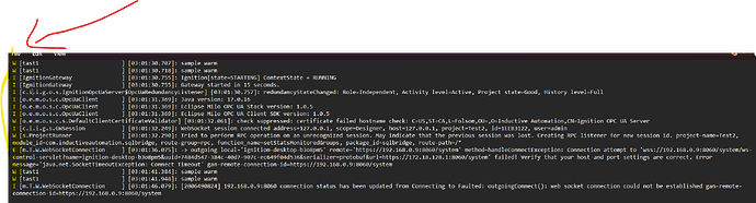

**Post date:** [November 25, 2025, 5:54pm UTC](https://forum.inductiveautomation.com/t/wrapper-log-log-level-info/112428/9 "2025-11-25T17:54:40Z")
I tried that. I do get the Initial of the log level type but its part of the message. By doing this I am hidding the log level and only displaying the message.
 ![image](https://us1.discourse-cdn.com/inductiveautomation/original/3X/d/c/dc50805682a1cfe0853b0e2eca0b27729b381adb.png)
**Post date:** [November 25, 2025, 5:56pm UTC](https://forum.inductiveautomation.com/t/wrapper-log-log-level-info/112428/10 "2025-11-25T17:56:17Z")
The "Message" from the service wrapper is actually the entire logging statement from Ignition, with its own level, timestamp, message, etc...
The log level is that single letter. If you want it formatted differently you need to modify logback.xml.

**Author:** ![felipemvcab](https://avatars.discourse-cdn.com/v4/letter/f/53a042/32.png) [@felipemvcab](https://forum.inductiveautomation.com/u/felipemvcab)\
**Post date:** [November 25, 2025, 6:21pm UTC](https://forum.inductiveautomation.com/t/wrapper-log-log-level-info/112428/14 "2025-11-25T18:21:53Z")
> [@Kevin.Herron](#):
> `<pattern>%p [%-30c{1}] [%d{HH:mm:ss.SSS}] [%t]: %m %X%n)</pattern>`
Thank you. It still only showing as part of the message but I think its getting me somewhere.
I could not make it show in the level field. Right now i am just using the M in the config file.
**Post date:** [November 26, 2025, 6:11pm UTC](https://forum.inductiveautomation.com/t/wrapper-log-log-level-info/112428/16 "2025-11-26T18:11:06Z")
THank you very much. Ill explore this option too. For now we were able to accomplish the goal by just modifying the xml file as suggested by kevin and turmel . By looking at the layout file, we modified the patter to look like this. Solarwind is now able to pick it up.
