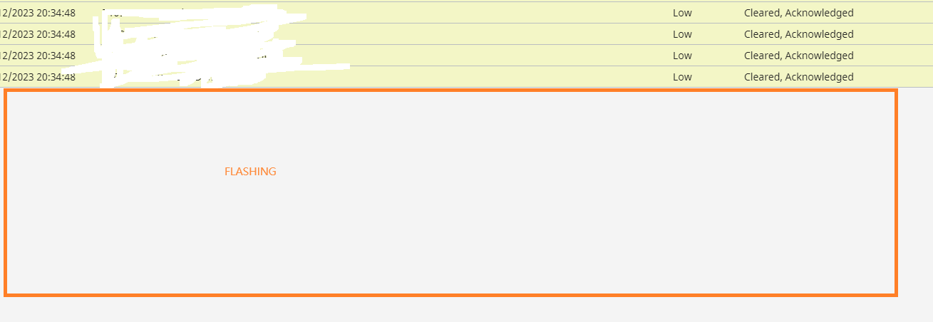

found another issue after adding the css.
When scrolling down the alarm table, the lower section of the page started flashing.
I cannot record the video, but from the picture below, the bottom part is flashing.
I tested all of the css declaration, the following setting is causing the issue. but if it's disabled, the text wrap function won't work.
 ![image](https://us1.discourse-cdn.com/inductiveautomation/original/3X/9/3/93d7e9e44b66061c8001a8aa38f2f4a488b3141b.png)
 ![image](https://us1.discourse-cdn.com/inductiveautomation/original/3X/9/c/9ccd2c89a4fe63230a348891c8a397a7b685c847.png)
Not sure how it can be fixed.
