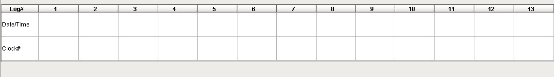

I have a data set that I created that is linked to the table shown in pic 1.
 ![pic%201](https://us1.discourse-cdn.com/inductiveautomation/original/2X/8/8ec99f891ae8fbb5b0d80175908ab8b11fc4b0e5.jpeg)
I have a tag that has a value, and I need to write that value to column 1, row “Clock#”. I have no idea how to write a piece of data to a particular spot in a dataset. Once I figure that out, I can handle triggering it to write, also writing the date, and incrementing the column number by 1 every time it’s triggered to write so that each new recording goes to a new column. Can anyone provide me with a brief explanation or paste a quick example of how I can write an existing tag value to the desired location on this table?
**Post date:** [September 12, 2019, 3:46pm UTC](https://forum.inductiveautomation.com/t/writing-tag-value-in-the-table-which-is-created-by-dataset/28214/2 "2019-09-12T15:46:00Z")
To start, try out the cell update binding and see if that works for your purposes:
[https://inductiveuniversity.com/videos/cell-update-binding/7.9](https://inductiveuniversity.com/videos/cell-update-binding/7.9)
