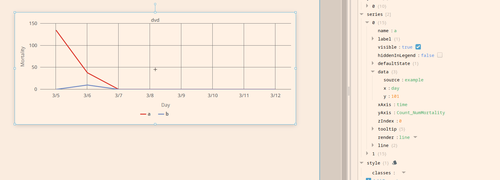

Hello guys,
I'm using the component XYChart in perspective, I'm getting data from query binding as dataset
 ![image](https://us1.discourse-cdn.com/inductiveautomation/original/3X/f/f/ff9580b7bc36a9a019177c2b7b41e59f0e68849e.png)
 ![image](https://us1.discourse-cdn.com/inductiveautomation/original/3X/d/1/d1902f4ba91636ef8cff2ade6865870a09a68c98.png)
Is possible to create series dynamically based in the amount of columns, in the dataset? because my columns can go from 3 to 26.
If you guys can point me in the right direction i will appreciate, also I'm no sure if this is the right approach.
thanks.

You would need to make a project script that will loop through your dataset and then build the series array to apply to the chart. Then you would call this script via a `runscript` call or a script transform on a binding to the series property.
The other way is to install the [Integration Toolkit](https://forum.inductiveautomation.com/t/automation-professionals-integration-toolkit-module/74934) from pturmel and utilize the `forEach()` expression method coupled with the `columnsOf()` method to build the series in an expression binding.
