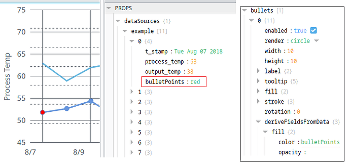

Help Needed: Dynamic Bullet Color in XY Chart Based on SQL Data (Perspective)
Hi everyone,
I’m currently working on a Perspective XY Chart, and I need help applying dynamic bullet colors in series[0] based on a threshold value.
✅ Objective:
Color the bullet (marker) of each point in the chart:
Red if the Y-axis value exceeds a threshold (e.g., \> 1)
Blue otherwise
📊 Setup:
Chart Type: XY Chart in Perspective
Series: series[0]

I bound series[0].data to the Named Query and applied a Script Transform to add a "bulletColor" key per row, like so:
newData =
for row in range(value.getRowCount()):
xVal = value.getValueAt(row, "Timestamp")
yVal = value.getValueAt(row, "NumericValue")
sourceVal = value.getValueAt(row, "Source")
newData.append({
    "x": xVal,
    "y": yVal,
    "source": sourceVal,
    "bulletColor": "red" if yVal > 1 else "blue"
return newData
In the chart configuration, I set:
series[0].x → "x"
series[0].y → "y"
series[0].source → "source"
series[0].bullet.fill → "bulletColor"
❌ Issue:
Despite trying this approach and variations of it:
The bullet color is not changing dynamically
Or the chart throws an error like "array found, string expected"
Or the chart shows no data
🧩 Questions:
1. Is this approach officially supported in Perspective for per-point bullet colors?
2. Does bullet.fill accept dynamic values from series[0].data rows?
3. Is there an alternative method (e.g., using scripting or styling per series) that works reliably?
Any guidance, working example, or reference is truly appreciated — I’ve been exploring this for a few days and would love to know if others have solved this cleanly.
Thanks in advance! 🙏

**Post date:** [July 5, 2025, 2:34am UTC](https://forum.inductiveautomation.com/t/xy-chart-perspective-dynamic-bullet-colour-change/108145/3 "2025-07-05T02:34:50Z")
Configure the color variable in `deriveFieldsFromData`
`series[n].line.appearance.bullets[0].deriveFieldsFromData.fill.color : "bulletColor"`
**Author:** ![backupaniket83](https://avatars.discourse-cdn.com/v4/letter/b/5f9b8f/32.png) [@backupaniket83](https://forum.inductiveautomation.com/u/backupaniket83)\
**Post date:** [July 6, 2025, 2:19pm UTC](https://forum.inductiveautomation.com/t/xy-chart-perspective-dynamic-bullet-colour-change/108145/4 "2025-07-06T14:19:59Z")
I tried setting series[0].line.appearance.bullets[0].deriveFieldsFromData.fill.color to "bulletColor", and my dataset includes that field with proper color values like "#FF0000" and "green", but it's still not working. The bullet type is set to "circle" and the data is correctly bound. Is there anything else I might be missing? Screenshot and structure below.

**Author:** ![Ujwal\_Wankhede](https://avatars.discourse-cdn.com/v4/letter/u/4af34b/32.png) [@Ujwal\_Wankhede](https://forum.inductiveautomation.com/u/Ujwal_Wankhede)\
**Post date:** [July 8, 2025, 5:22am UTC](https://forum.inductiveautomation.com/t/xy-chart-perspective-dynamic-bullet-colour-change/108145/9 "2025-07-08T05:22:56Z")
I suspect you're using "bulletColor" as a quoted string, which might be causing the issue. If that's the case, it won't work as expected.
Here is the working sample below:
 ![Bullet Example](https://us1.discourse-cdn.com/inductiveautomation/original/3X/1/3/13f3a16bdaad4b9c446ee437d0f29b323d31cdc8.png)
