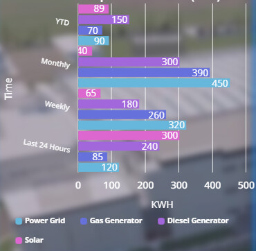

**I am looking for the best way to display data values directly on or inside the bars of a Bar Chart in Ignition. Could someone clarify the steps for both Perspective (XY Chart) and Vision (Bar Chart component) to ensure the labels are clearly visible to users**

For Perspective’s XY Chart, read this post
> [@\[FEATURE-10589\] Perspective Bar Chart value labels](https://forum.inductiveautomation.com/t/feature-10589-perspective-bar-chart-value-labels/30531/2):
> I think i may have just figured this out. Using an XY chart i created a bar graph using the column renderer. then i copied the series and changed the renderer to line. this adds the property “Bullets”. Choosing the label bullet type and then linking to the proper field in the data i was able to have labels. i set the stroke width on the line to 0 to make it disappear and played with the offset property to make the label appear at the top of the bar.
Edit: for Vision; there is a checkbox under the Appearance property called **Labels?** , this will show/hide values on the chart.

Thank you for sharing, out put was attached below format
 ![image](https://us1.discourse-cdn.com/inductiveautomation/original/3X/2/1/217d7937d26969d1c42e9577429f7b474eebf0a4.jpeg)
