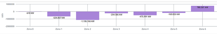

Hello all!
I would like to know if it´s possible to configure XY charts to have text within the bars as shown in the following example:
 ![image](https://us1.discourse-cdn.com/inductiveautomation/original/3X/a/e/ae2c1650ebbe0495aca0e04069b46a6ba294869c.png)
I have try different configurations and some posts on the forum and havent find the way.
Cheers!
**Author:** ![ryan.white](https://sea1.discourse-cdn.com/inductiveautomation/user_avatar/forum.inductiveautomation.com/ryan.white/32/73193_2.png) [@ryan.white](https://forum.inductiveautomation.com/u/ryan.white)\
**Post date:** [September 30, 2025, 3:21pm UTC](https://forum.inductiveautomation.com/t/xy-charts-with-value-inside-the-bars/111096/2 "2025-09-30T15:21:56Z")
Create another dataset driven off the first where the value for each point is divided by 2, or add a new column to the existing dataset that holds the half value. From there, use that new dataset/column to drive a line type series with an invisible line and bullets with labels enabled. Configure the labels to show the original value.

Thanks Ryan, seem like a good idea!
 ![image](https://us1.discourse-cdn.com/inductiveautomation/original/3X/8/8/88e494e804e54cb6ae80581adc98e5654b25ba6a.png)
I used two series from the same dataset, one render bar and one render line.
 ![image](https://us1.discourse-cdn.com/inductiveautomation/original/3X/d/9/d9bf17b501482980ed6c32e8515b2e897354c0cf.png)
Now I just need to play with the bullet position.
