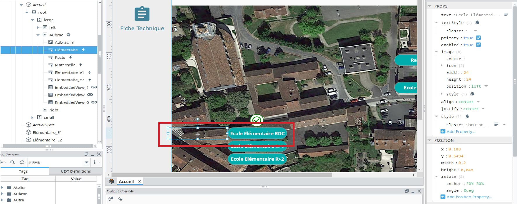

Hello,
I'm experiencing a display bug in Designer's perspective mode (I'm using version 8.1.48 of Ignition). I have a view composed of a Breakpoint Container to have two displays depending on the screen size, and for the "Large" mode, I have a Row Container to chain 3 XY Containers in a row.
The left and right containers are in "Fixed" mode, and the middle one is in "Percent" mode because it contains a map that needs to adapt to the screen size. This is the container where I'm having an issue. Basically, there is a mismatch between the "anchor" of the object and the object itself, and I feel like this mismatch is directly related to the size of the left container. I've tried adjusting the grow/shrink properties, positions, and some style props, but nothing works; I still have this mismatch.
 ![Display_bug_XY_container](https://us1.discourse-cdn.com/inductiveautomation/original/3X/2/d/2d4055dbea94813109fb404c947e268c6cfa16d8.jpeg)
It's not critical, but it makes the display less clear on pages with many objects.
Does anyone have a solution?
Thanks !
**Author:** ![kvane](https://sea1.discourse-cdn.com/inductiveautomation/user_avatar/forum.inductiveautomation.com/kvane/32/22228_2.png) [@kvane](https://forum.inductiveautomation.com/u/kvane)\
**Post date:** [August 12, 2025, 10:44pm UTC](https://forum.inductiveautomation.com/t/xy-container-display-bug-on-components/109644/2 "2025-08-12T22:44:51Z")
Hello Carla,
Thank you for sharing the details, this is very likely the same issue as [here](https://forum.inductiveautomation.com/t/bug-1485-nested-containers-not-aligning/107843) since the percent coordinate container is in a flex. There is no clean solution at this time that wouldn’t require changing containers, but I will add this post to the internal ticket tracking the issue.
