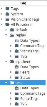

As a side note,
I’ve tried to create another realtime provider named “test” to test scan class and tag import, but when I’ve created this new provider, the data are mixed in the designer between this new provider and other managed tag provider…
Before
Create another realtime provider : “test”
tags of the managed provider “replay” are displayed both in “replay” provider and the new “test” created !
Yeah, I don’t have any good answers today. I did notice that your 8.0 tag group export json contained {} at the top, but I cannot provide any explanation of how it got there. After I removed the empty entry, I did not have any problems with importing the default tag group. The 7.9 scanclasses csv also worked without issues. Whatever happened must have happened the first time you imported 7.9 scanclasses. I also created several new realtime providers, and I can’t see any duplicated tags between providers. Without being able to reproduce what you saw, we are kind of stuck.
