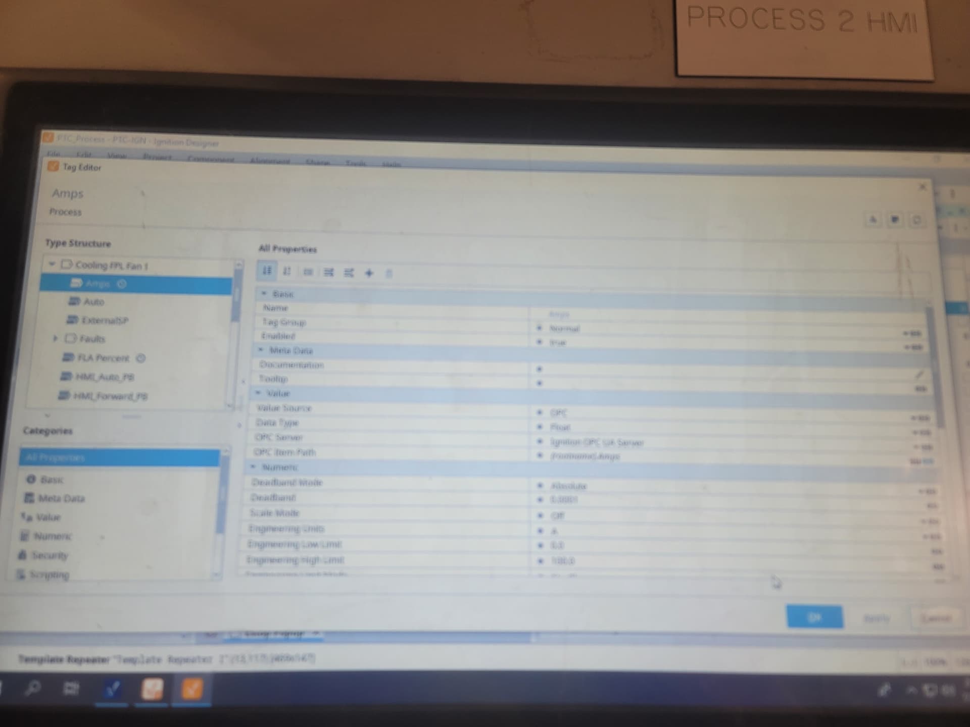

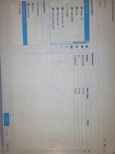

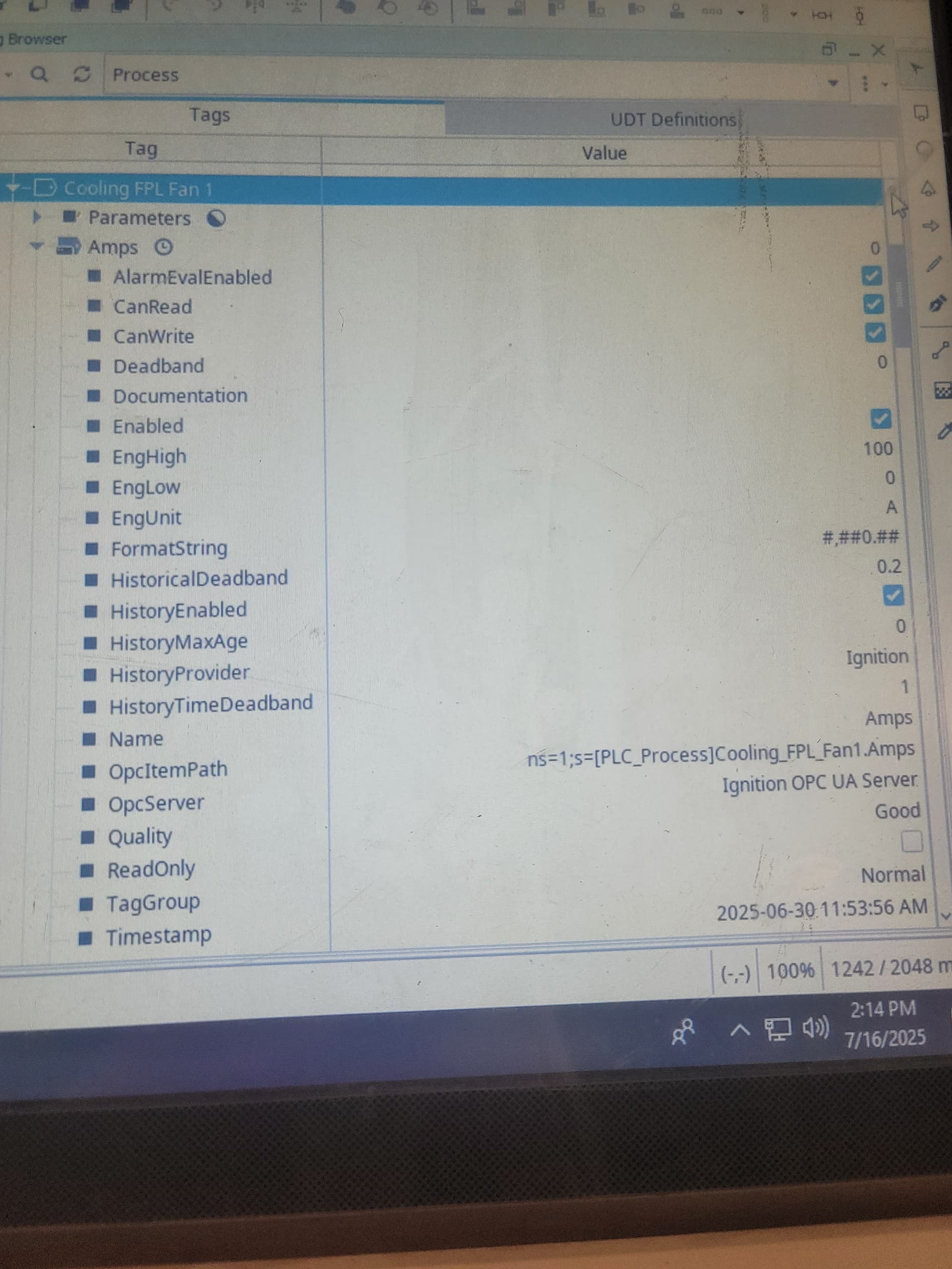

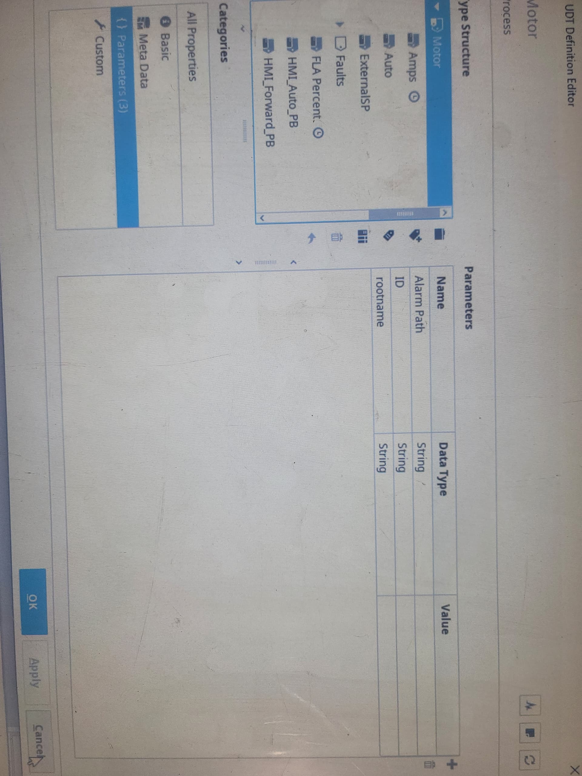

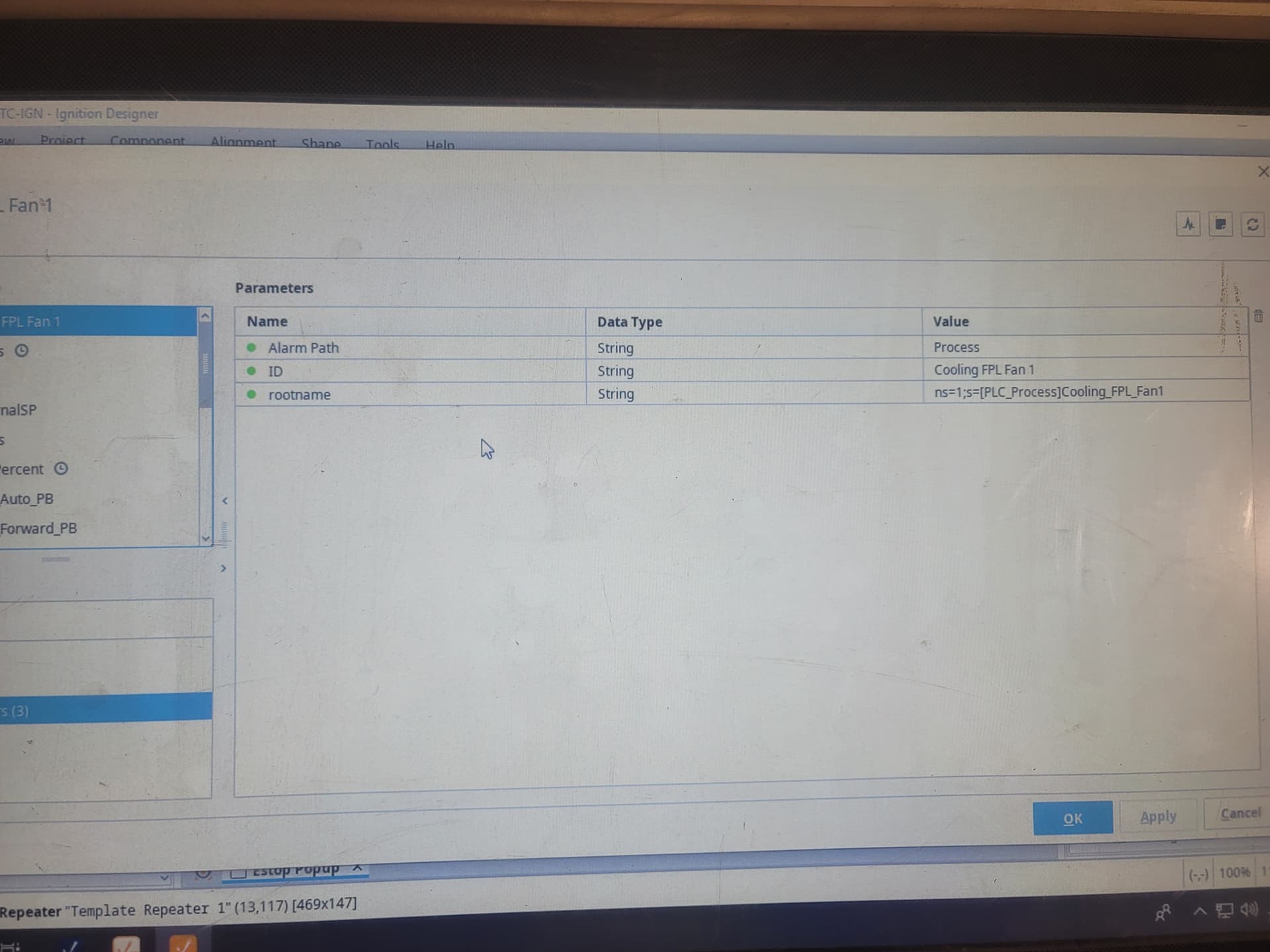

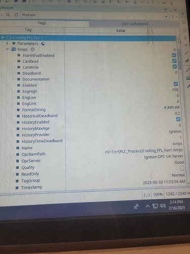

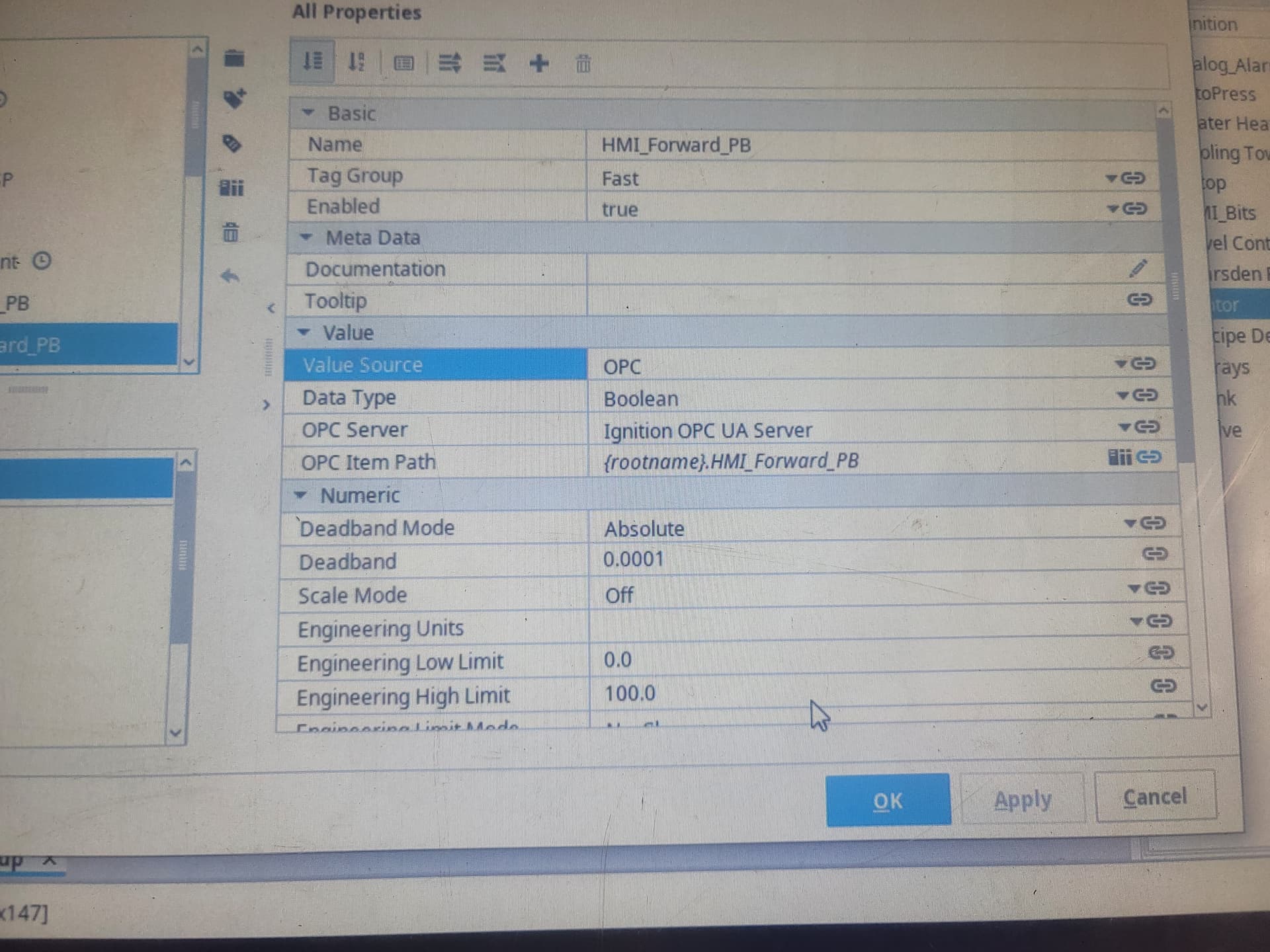

Heres an example of one of mine for Rockwell. Onsite and little time, so sorry for the crappy picture quality. First pics show UDT structure...last pics show tag and resultant tag path formation.
[PLC_Process] is the Device ID declared in the Gateway. I assume you've added a device for siemens in your gateway.

And this is the OPV Browser view :

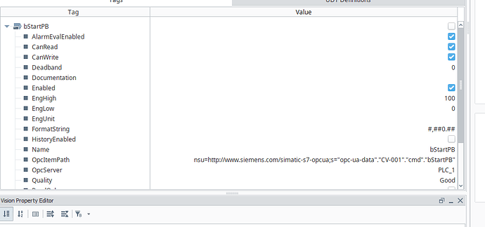

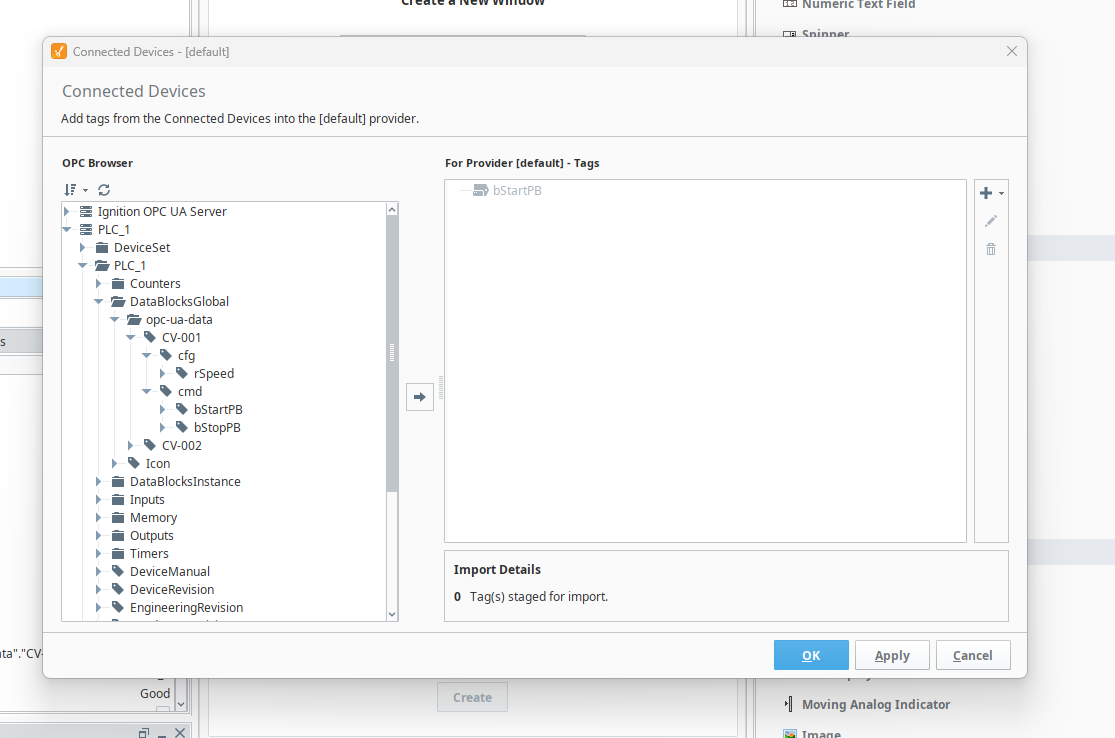

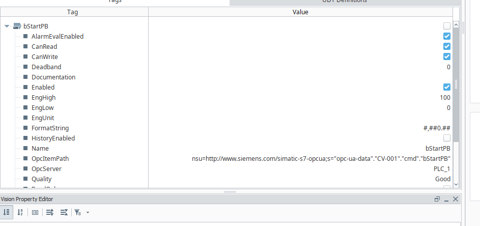

So for your parameter, for the tag you'll want everything up to ".....Cv-001" including the quotes.
In your UDT for the start pb member, youll want {DeviceName}."cmd"."bStartPB".
Then, the path will be formed to include the value in your Parameter DeviceName + the remaining part from the UDT definition, such that it matches the one tag you show.
Im not sure if the "" quotes will resolve correctly, so you might have to play around with that if they are stripped out on forming the final path.

Thank you so much for the time, it did work

If you note on my examples, i use a device ID for that purpose of diagnostics, and my tag name UDT instence matches the tag name in the PLC. While my IDs follow P&ID nomenclature, my customers prefer real descriptive tag names in the PLC instead of device names. So, I accomodate that with the extra ID parameter that binds to all alarms, mouseovers, popup titles, etc.
