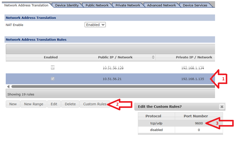

Adding one Note, also maybe will be needed to add a PORT in the CUSTOMS rules for the NAT entry of the PLC, as example for OMRON you have to add 9600 as tcp/ip port if not, it will answer a ping but will never connect from ignition/CX software, check example image.
