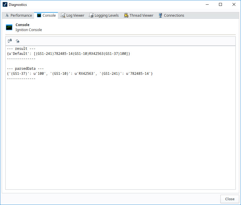

Extracting data from QR to a form
Yeah, probably so. Thank you for all the help though
The regexes are looking for separators that don’t seem to exist in your QR.
Try using the string method.
result = event.toDict()
fieldDelimiterList = ['(GS1-241)','(GS1-10)','(GS1-37)']
parsedData = parseString(result['Default'][0] , fieldDelimiterList)
Your original code seemed to be the what you needed, here is another example I found from sepasoft that you probably already had, but this is probably the best

I tried this and now instead of an error popping up, I get an error in the textError box that says 'No matching patterns were found in the raw barcode'
With this I get a KeyError: Default
Is Default enabled in the Pattern configuration?
It wasn’t selected anymore but I went back and selected and no still get the same error.
Did you save the project after the change? :wink:
This is the script I am using:
def parseString(stringIn, delimiters):
	##  parse a delimited string and return a dictionary  ##
	##  NOTE: Be sure the delimiter list is in the same   ##
	##        order as they appear in the string. Save    ##
	##        yourself some pain. :)                      ##
	# Create a list of lists that contains the indexes of where each delimiter appears,
	# and the length of the delimiter, so we can use them to say where each field data lies.
	indexList = [[stringIn.index(delimiter), len(delimiter)] for delimiter in delimiters]
	# This is just a pointer that we'll use later to flag when the last iteration of the
	# following loop is in play.
	last = len(indexList) - 1
	# Initialize the output dictionary.
	dictOut = {}
	# populate the output dictionary with the field data
	for index, delimiter in zip(range(len(indexList)), delimiters):
		# set the start of each field data
		start = indexList[index][0] + indexList[index][1]
		# set the end of the field data. This is treated differently if it
		# is the last iteration.
		if index != last:
			end = indexList[index + 1][0]
		else:
			end = len(stringIn)
		# Add to the output dictionary
		dictOut[delimiter] = stringIn[start:end]
	return dictOut
print '--- result ---'
print result
print '--------------'
print
parsedData = parseString(result['Default'][0], fieldDelimiterList)
print '--- parsedData ---'
print parsedData
This is what I have in my console:
So apparently there was an issue with the scanner I was using. Once I got a new one and set the prefix, this worked.
I want to thank you both for all your help. Between code and bad hardware, it made it tougher than I thought it would be.
