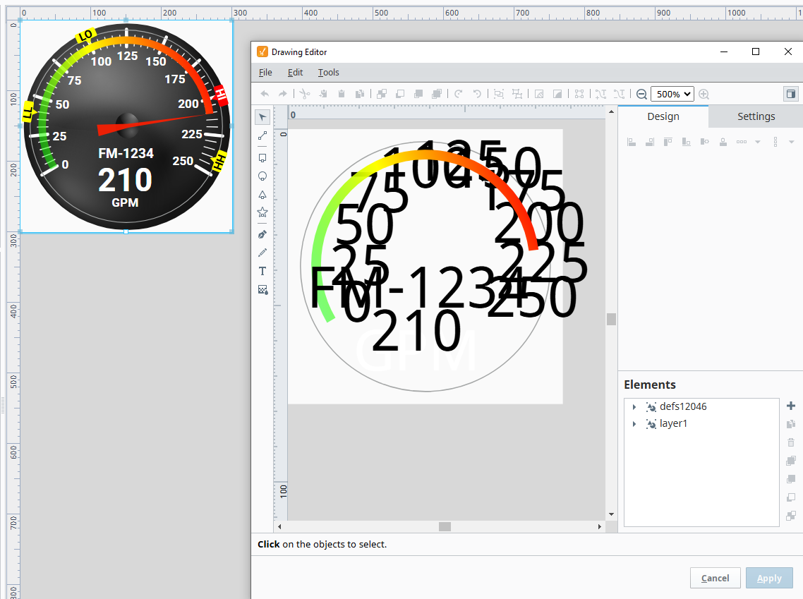

Another interesting behavior. I was just testing the exchange import tool and I imported a gauge tool I put on the exchange a while back. When I go in to edit the SVG it displays the numbers as unstyled in the drawing editor as expected.
This is the resource I'm testing with.
I suspect a style editor is probably more difficult to implement than I first thought it would be. I just wanted to mention the caveat so send you down a rabbit trail. At the very least, here is some test fodder.
