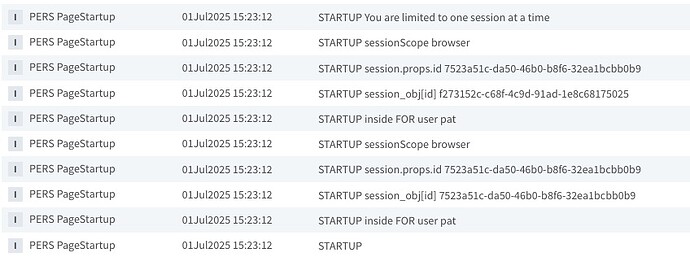

This is mostly working, but the log is showing the original session is being closed instead of the new session. What I want is to deny the second session from logging in if it is the same user as the original session.

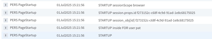

The first session login shows this in the log:
When I login again with the same user, you can see the session id that gets closed is the original session:
Is there a way to get it working the way I want?
This cannot be made reliable, as sessions can live on well after the browser has closed the tab or shut down. The "disable previous sessions" approach doesn't have this timing problem.
