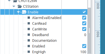

I have removed the script but it does not change the OPC tag when I check it.
The Tag path in your binding dialog doesn't match the Tag displayed in the Tag Browser panel. CHUTE21 vs CHUTE26W.
Sorry, I had the wrong one open.
Here is the correct pic.
Are you sure nothing else is writing to that tag? Can you toggle it from your tag browser?

I am sure. I even dragged the tag to the view and recreated the checkbox.
When I toggle from the actual tag, it did popup and asked if I wanted to write once or enable read and write.
I enabled read and write and it now works.
Where, when settting this up, would I change this to read or write?
Thanks Andrew
Read up on comm mode.
